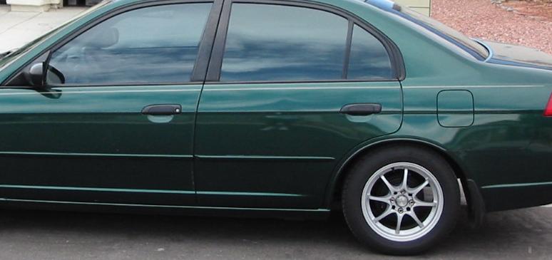

I have the Heliums and I think they are real ugly. But they are cheap and light. All the rims I like are heavy.

Originally Posted by gearbox
pics? do you have silver?
After they were on the car, I wish I hadn't got silver. The color I should of got.
