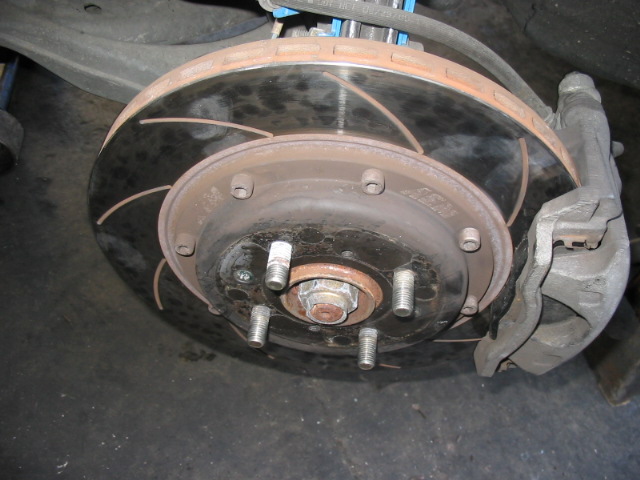

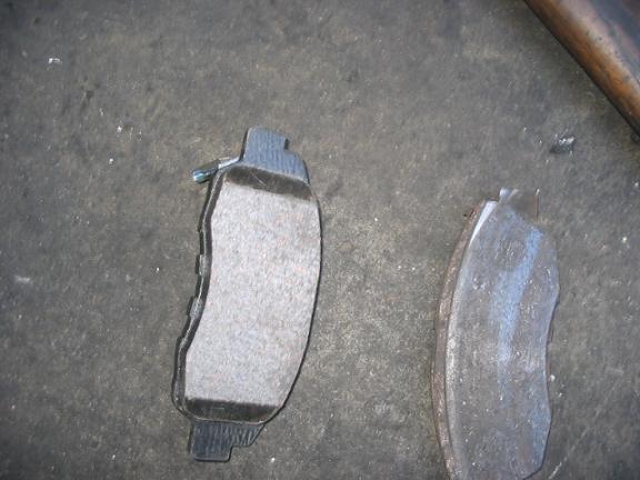

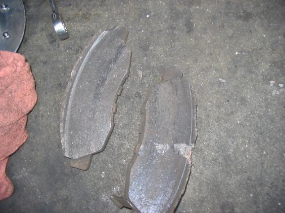

damn took my freaggin hours to do it. My other dude showed me a different way and it seems as if his way is right. Ill I did was took a screw driver and stuck it in between the caliper and pushed the used brake pad where the piston was. One of them was easy but the other one was hard. Tooke me a good couple hours. It was my first time, now I know it will take 30 mins or less.
heres pix. whoever knows if my rotor is on right let me know please. I think they are starting to warp. NEver again aem pads. Look at the pix of the aem nissin pads after a month. Compared to the axxis brand new pads. I did feel a little less pedal effort from the axxis pads, but I think this is because the axxis pads were smaller but thicker while the aem pads were wider but thinner.
ALso can someone let me know if my rotors are on the right way. I didnt remember if it mattered but someone here said the pads would wear out faster, so maybe that could of triggered the aem pads to wear so fast.
the pic of the rotor is on the driver side..

Old Apr 6, 2005
djmota's Avatar
Posts: 3,242
From: so cal djmota=oscar
Rep Power: 323
you have the wrong rotor on the wrong side this is why the pads wore out quick. You will need to switch those or you will have the same problem.

so djmota you sure my **** is on the wrong way?
Old Apr 6, 2005
djmota's Avatar
Posts: 3,242
Rep Power: 323
yup. it also explains why the pads you got wore out so quickly. Do a search thru members rides and look at some pics for proof. I also have slotted rotors and aem pads facing the opposite way your are with over 30.000 miles on them with no wear problems.

Old Apr 6, 2005
Civic_RedLine's Avatar
im stock now! T.T
iTrader: (18)
Posts: 2,665
From: CA
Rep Power: 289
Civic_RedLine will become famous soon enough
sorry, the pic I have of the rotor is on the right way. If you see the rotors up close they are warped like a ****. thats like after couple months of usage. The pics shows the rotors switched around already. Yesterday it was the other way around. I drove maybe 30 miles today and the warping went away so this is the right way.
