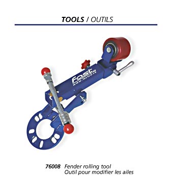

Take it to a body shop! DO NOT USE A BAT OR CUT. The body shop will use an air saw to cut them and them add a anti-rust/primer stuff and then follow behind it with touch up paint or etc. Best thing to do is get it cut in the center of the pinch welds. If you cut past the pinch marks your inner and outter shell will seporate and the metal will start to weave and not be structually sound. Now even better is to have them rolled with a pro-tool. There expensive so most body shops don't have them but if you can find a body shop with one they will heat up the metal & paint and use the tool and it will roll them slowly and perfectly. I attached the tool.

the place i got my wheels/tires from has that tool...but they won't touch it unless they show me how to use it because the people there have cracked paint on their own and other's cars using that same tool that you attached. they just don't want to be held resposible for that kind of stuff...so i chickened out because i don't wanna crack my paint or have them do it and it possibly cracking also...
