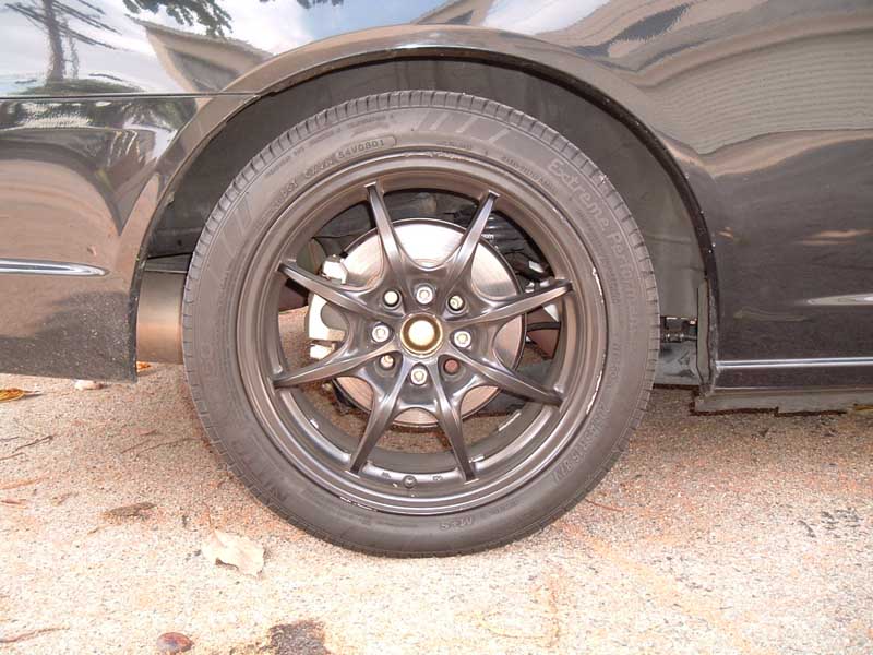

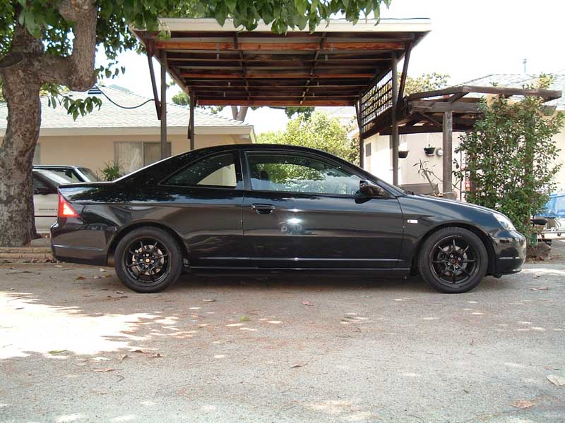

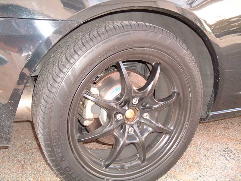

I would like to thank Drivetofast for making this possible. Excellent guy to work with. Anyway, enjoy the pictures! Peace!
-=Hopefully the pictures work=-

nice, how does it feel?

Nice job.. Still a 4X4, but nice.

ya know, that in terms of handling performance, there is such a thing as too low.

nice and clean r those rotas

PunkingCivic - When I step on the brakes, they feel wonderful. I tried stopping at 40mph and stops on a dime(well not on a dime, but they feel very different from drums).
allmotor - Yeah those are rota C8's. I'm planning to sell them in the future to get Velox.
Thanks everybody for the replies. I appreciate it. Yeah, it still or kinda does look like a 4X4 even though it's lowered. I'm waiting for the slotted rotors for the rear. But my project is far from finished. I have a long way to go. Will be posting new pictures soon. Peace!
