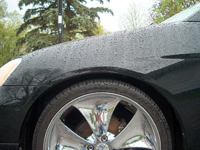

Same here, 225/40-18 are definatley a little too big. 215/40-18 would come closest to stock overall diameter and still give you a little more sidewall, I had 215/35-18's with about a 1.25" drop and never had any rubbing but the ride was a little harsh with those tires. The pic below is of my front gap with H&R's and konis.
