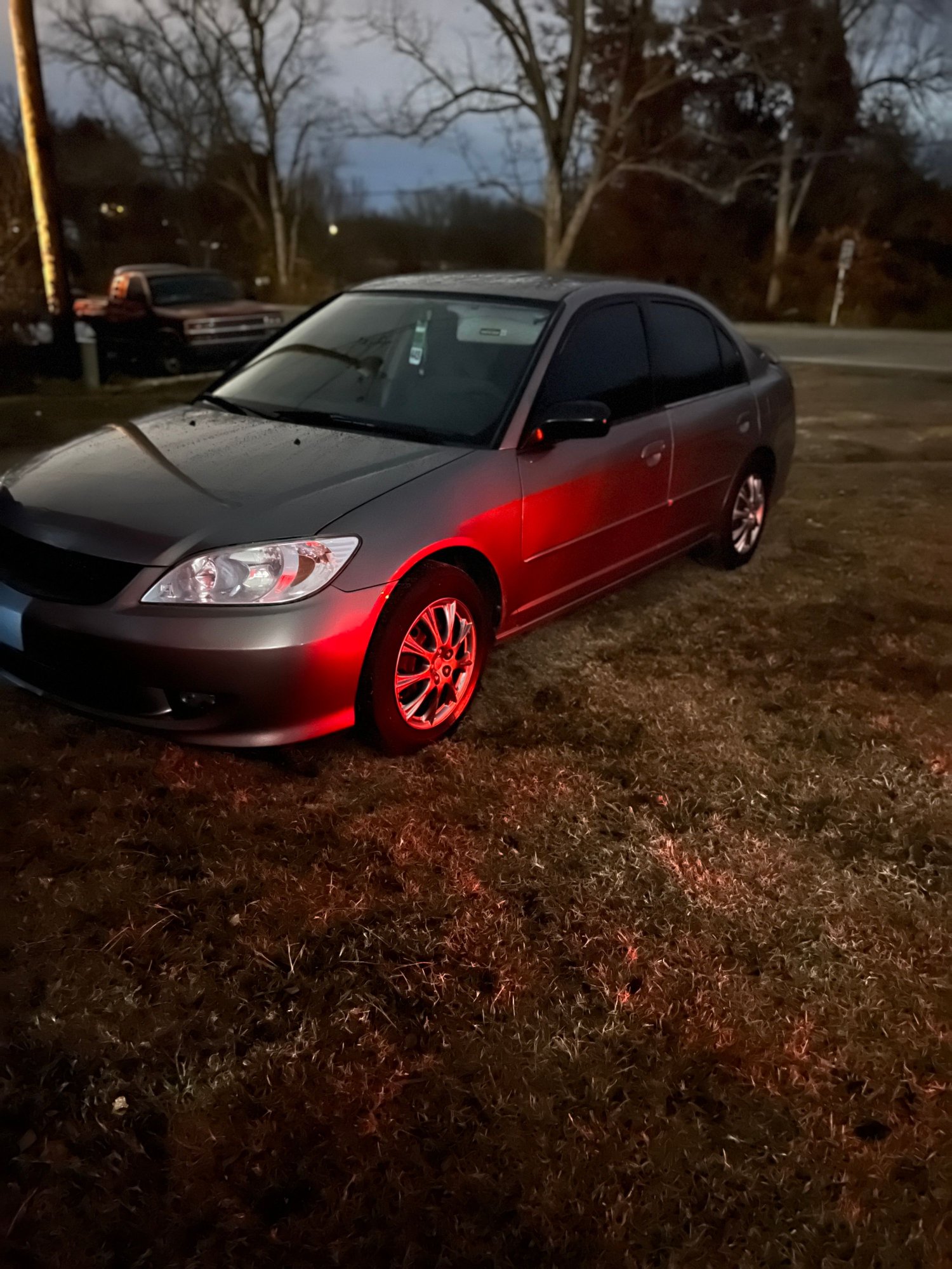

My dad recently passed away and I inherited his car and I want to make it look an run
My dad’s old civic
awesome

Change the rims and it will look nice, and then just maintain it and it will run great.

Lower it a little if you're going for looks. Like 1.5" drop looks much better in my opinion.

sorry for your loss! look into lowering it, makes these cars look super good.

What are some value options for lowering??

Coilovers would be the only real option, in my opinion. Sure, lowering springs can work, but they don't offer the adjustability or the typical ride quality that a coilover will.
As far as brands go, Yonaka, KW, and Tein would be the budget go-to's. There are cheaper options such as Raceland and Maxpeedingrods, but I didn't recommend them for a reason.

tein s-techs will give you a nice 1.4" drop for not much money. You'll want to look into struts that can handle the drop, but they'll run on stock struts without blowing them for a fair amount of time (my 2002 civic ran on tein springs with stock struts for 40k before I swapped them out, and the ride got so much smoother). Springs will probably run you $200, struts maybe $400
Or...
You can go with a tein street basis coilover set for $600-700ish. That way you get adjustable height and struts that are paired with the springs. I'm a big proponent of Tein, even though they moved most of their production to China. Still a great budget option though. The only ones they make that are still manufactured in Yokohama, Japan are the Flex Z series, and those can be 1000+
Rims and drop will give it a nice look tho, for real, even if it's stock body parts

What he said.
That's already a clean looking car. Put some shoes on it and leave it be. Maybe a decent cat-back if you want a little more ear candy.
