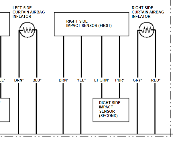

This is what I could find.
'01 Civic side air bags:
'06 Civic side air bags:
