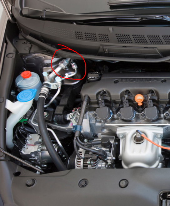

other end of that large line at the car not the compressor end but up under the lip on the firewall there are two very large alloy [soft] hexs way over 20 mm ie bigger then my crowsfoot set
the big line broke and spewed out the 134+oil I suspect bad motor mounts allowed too much movement ripped the rubber on a speed bump

You're talking about these? Can you get a couple crescent wrenches on it?

a do not have a 2X MM open end or crow
soft alloy so do not want to use a big adjustable on the outer nut/hex
the other bigger fixed nut/hex is too tight back in there to fit the adj back under the lip

The plastic cowl tray can be removed. I have used a crescent wrench on similar connections for other Civics without issue. I can't imagine yours being much different but I have never tried on this specific model.
