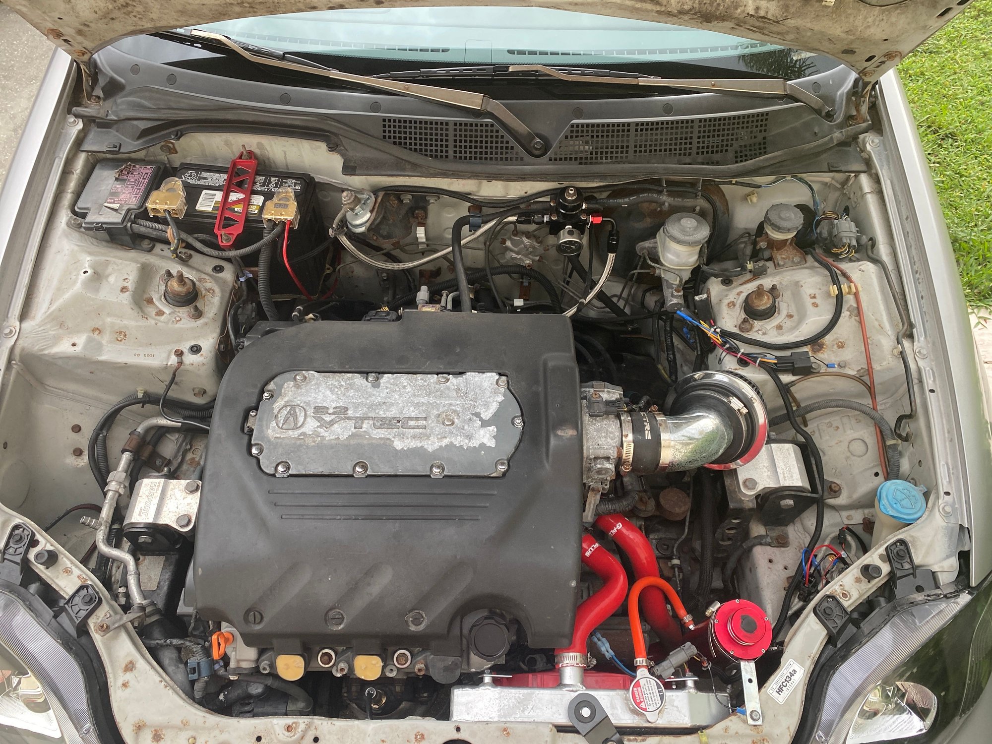

Hey guys just bought a new J32 / type s 6 speed civic. It runs pretty good. Everything is stock!! Stock ECU. Everything works. My problem is that when it idles it idles too low.. if i turn on the ac it stalls whenever i come to a stop. How can i fix this issue?

Well the ac is cold when I’m driving it’s just the idle is rough. It has a serpentine on it, but it does bog down quite a bit when I turn on the ac. Other then that the car is great.

So i cleaned the throttle body and it seems to have cleared the idle issue. The carbon build up around the throttle plate was bogging it down.
