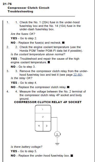

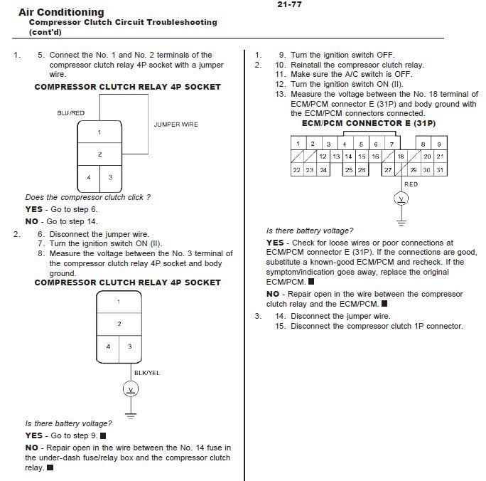

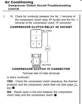

I managed to source a repair manual for the 01 civic, which should work on my car. I'm currently trying to work my way through the troubleshooting for that. On step 8 my tester isn't lighting up so I'm going to look more into that.
I'm hoping at this point that it is just a leak, as that sounds easier to repair than trying to rewire something. On the plus side, the clutch was clicking when I jumped it (step 5), so that gives me some hope.
Well that's important. Did you have the key on? Does the A/C indicator light come on when the button is pushed? You should see battery voltage there.
