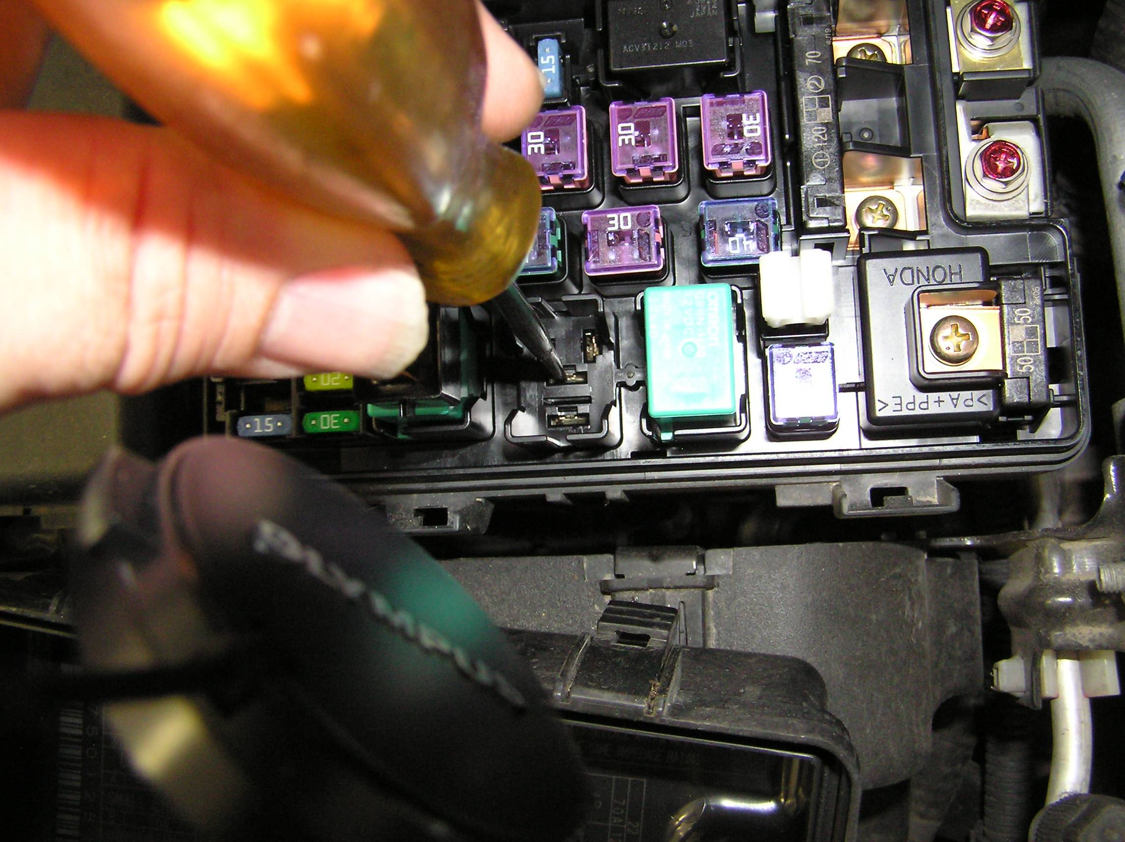

Thanx. Here's pics. I'm checking the contacts side of the relay circuit, and bypassing the relay. right now I'm ignoring the control side of the relay (its coil or winding) as I already checked it earlier. Name:  QZGFsET.jpg
Size:  408.0 KB Test light connected to ground, probing for B+. This shows my fuse is intact for the clutch. Name:  lnoFlTD.jpg

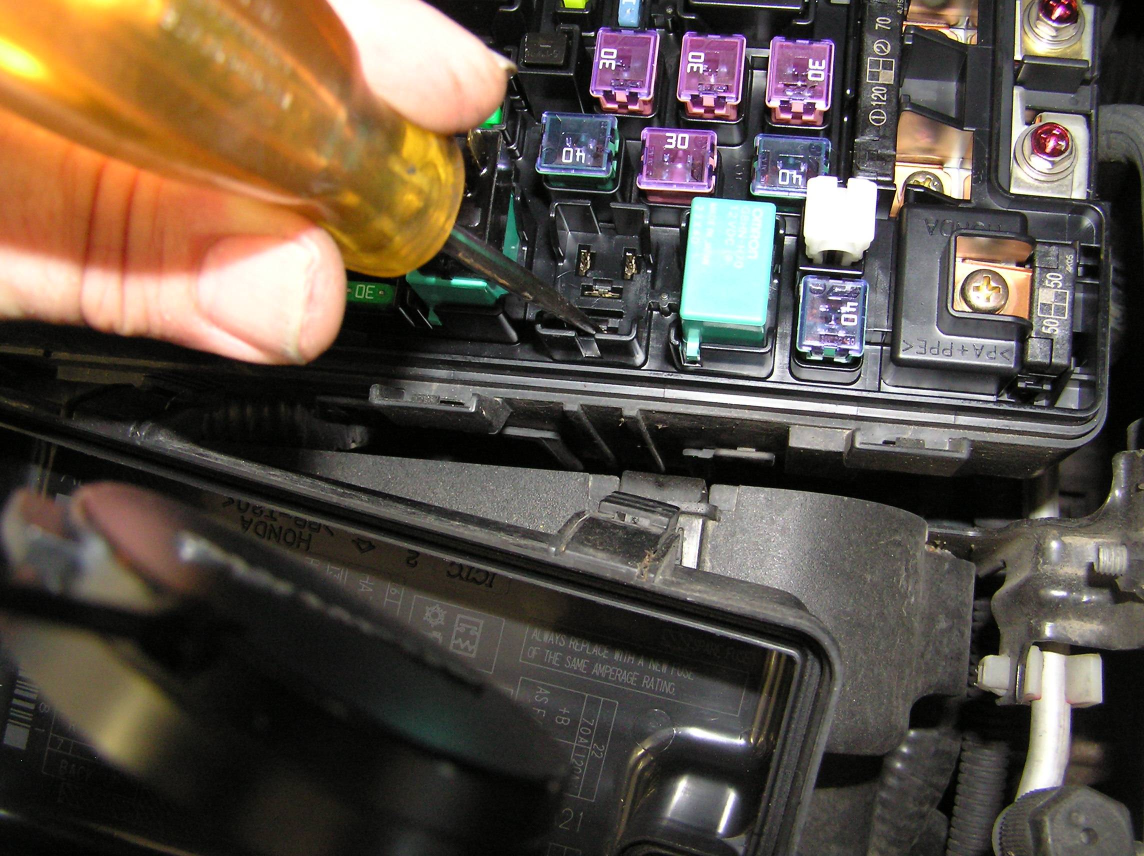

Size:  370.0 KB Test light is now connected to the positive battery terminal because I'm looking for a ground. The winding of the clutch electromagnetic coil is grounded and provides enough continuity to illuminate the low wattage test light as I probe the other female terminal in the relay socket. The light lit so I know the coil has some sort of connection alll the way to its ground. No open circuit.
I know I SHOULD be able to make the clutch click from this point now. I have power and I have a complete circuit through the clutch to its ground. Name:  O7csyON.jpg

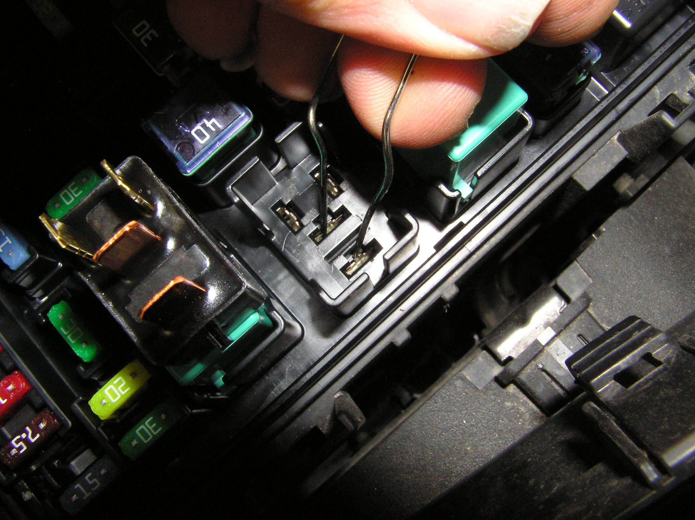

Size:  353.4 KB Now I jumper those 2 terminals with the paper clip (it was handy). If the clutch clicks, it's good enough for the moment. If it doesn't click, then I can chase whatever is wrong. I was actually doing this to check and adjust the clearance or gap of the new clutch I installed, using a dial indicator.

Test light bulb and paper clip seems pretty easy to me. Cheap as hell too.
Guesses can be needlessly expensive...as you listed above. Parts replacement can't solve all problems. Cue the parts cannon pic!
Clutch set from Honda normally consists of the pulley and outermost plate, plus C clips and shims. Coil is the electromagnet that engages the clutch. I use ladyfoot prybars or hammer and chisel or a real puller to get the pulley off the snout of the compressor. Just don't damage it, it's a tight fit!
If your fans keep on running when the compressor quits, it is NOT the pressure switch. (As long as it isn't coolant temperature turning the fans on.) This should be seen in the wiring diagram.
