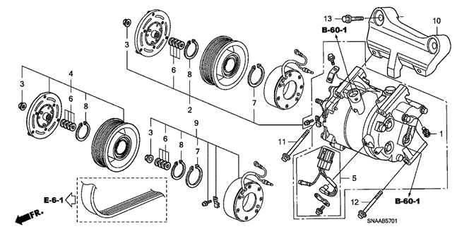

I am having a similar issue and I am suspecting a failing clutch on the A/C compressor. It will start out working ,fans engage, generating cold air and the clutch is running but after things get warm under the hood the clutch will stop engaging and I could see it slip. If I tapped the clutch carefully while running it would start up run for a few cycles and stop again.
The system is charged, high and low side pressures appear to be in the normal range.

Well if the compressor is not running that is definitely the problem.
The question is why is it not running....
The field coil is basically a big magnet that pulls the clutch against the compressor. The clutch is the part where the belt is actually turning the unit, so when the clutch pushes against the compressor, the compressor turns.
May be a tad bit difficult, but when the problem happens, see if there is voltage being supplied to the field coil. If there is AND the compressor is NOT running you may have a bad coil.

Sounds like both of you need to see if the electromagnetic coil is still ok (resistance check, and check that it's still getting power), then see how much clearance the clutch plate has.
If the clearance is too great, they will quit engaging when they heat up.
Spec is 0.35-0.65mm (.016"-.025").
Watch the clutch plate move in as it engages, see if it LOOKS like more than a half millimeter of movement.
Gap increases with wear, and by 200K they can have a lot of wear..

Daughters 2008 had this same issue. Diagnosed it down to the clutch. I really did not want to replace the whole AC compressor as I did not feel like opening the high pressure freon system (it was blowing cold and pressures were fine while it did spin).
Ordered a replacement clutch off eBay and was surprised the quality of the unit was good. It took me about 4 hours to do the job. Removed the mounting bolts and wiring harness from the compresor but left all the hoses. This allows the compressor to rotate a bit to get to the front nut that holds on the outer clutch plate. I used a handheld battery powered impact driver and it removed this easily. The really difficult aspect of the repair is removing the circlip that holds the old magnet coil to the compressor. It's down in a groove and difficult to reach. The ONLY tool to get to this clip was the Channel Lock tool here:
Even with this tool I had to extend the two prongs out about and extra 3/8" to reach the clip. Without a good cir-clip tool don't even start the job. Trust me as I broke three cheap ones I had in my tool box or purchased.
Once completed I ensured all wiring was secured as OEM had it. I put on the belt and started it up and it's been cooling great ever since. Remember this thing vibrates a lot at idle so if you skimp and do not secure the wiring correctly you will be doing this job over for a broken wire in a month or two.

If it cools well when the clutch does kick on then try to remove the clutch plate and remove the spacer washer. Some guys report that allows the worn clutch to last another 10-50K miles. Mine was a bad internal coil in the magnetic clutch. Replaced and works well. If you can kick the clutch in by tapping it with a small hammer then the coil is OK and the spacing is just worn. Be careful with the hammer tap as it's tight in there and the last thing you want is to be injured or damage the car.

I wanted to shed a little light on this issue. There are a lot of forms about A/C not working.
There is one where the A/C not working at all where the Relay in the fuse box under the hood is bad, i had an issue with that really also having the a/c clutch locked on and actually killed my battery when it was off. easy fix after diagnosing.
Most recent Issue was A/C Clutch engaging intermittently. At first start A/c will be fine and ICE cold and 15-20 min later it would stop and just blow hot air. ill turn the a/c off and maybe dive 10-15 min and attempt to turn on A/c and it might or might not work (hit or miss)
I knew a/c was full an no leaks so i narrowed the problem down to A/C compressor/Clutch as i checked all my relays.
My test was not very safe or recommended but after the a/c stopped working after the 15-20 min. while the car on and "a/c controls on" i used a metal rod and manually pushed the a/c clutch plate against the spinning pulley and a/c kicked on and stayed on.
So to fix it i ordered a kit from eBay to replace pulley and coil. I did not want to replace entire A/C because i would have to deal with getting it filled with thw 134A again and all that so i tackled the Job without disconnecting the lines from the a/c though i did need to take off the 4 bolts that held the A/C against engine.
Here is the link i ordered the kit from:http://www.ebay.com/itm/NEW-A-C-Comp...72.m2749.l2649
Now i changed everything on the kit, the kit comes with 2 washer spacers but tells you the spacing it needs and i only ended up using 1. Its been 2 weeks and A/C has been working great. I been using it every day to and from work.
Now that i think about it, maybe replacing just the front plate (in-front of the pulley) would of been fixed the issue because when i compared the OEM one with the one from the kit, the one from the kit was thinker so possibly the old one was just so worn that the spacing was too much between the plate and pulley that it wouldn't engage.
Hope this helps.

Or you could have just removed a spacer/shim from the shaft and the clearance would enough to activate the clutch again. Over time the clearance can get out of spec.
