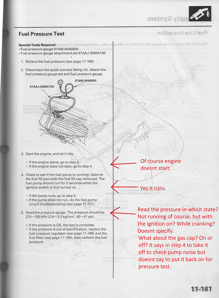

Ok. The fuel pressure test went like this...
  1. Hooked up Actron CP7838 fuel pressure tester in engine bay on hard line from fuel tank. NOTE* gauge was not BETWEEN tank and fuel rail/injectors. Tank-fuel line-gauge = deadhead was how it was hooked up.
  2. With key-on-engine-off pressure reading jumps to 39psi and within one minute drops to 35psi.
  3. With engine cranking, pressure is steady 42.5psi. Stop cranking and it immediately drops to 39psi and within a minute drops to 36psi and then steady drops from there down to 34psi after about 4 minutes. I didnt let the pressure hold any longer than that.
Check the picture I posted from my Honda service manual. If the pressure is to be taken with the key-on then the fuel pump it out of spec. If pressure is to be taken while cranking but not running then the fuel pump is within spec.

  #40
re: Won't start Any guesses? [solved - headgasket]
Bottom line was the fuel pump has to be operating, and preferably operating at full system voltage to get an accurate fuel pressure check.
Pressure is in spec. Move on to something else.

Originally Posted by nola000
Ok, but while I have everything out should I do this test again with the gauge BETWEEN the tank and fuel rail/injectors? Would I stand to discover anything on the fuel rail or injectors with those items as part of the pressure reading?
The test you performed was just fine, pressure was within spec.
Move on.
The design of this particular "returnless" fuel system allows me to say that.
IF this system had a pressure regulator on the fuel rail, connected to engine vacuum, that would make the situation a bit different.

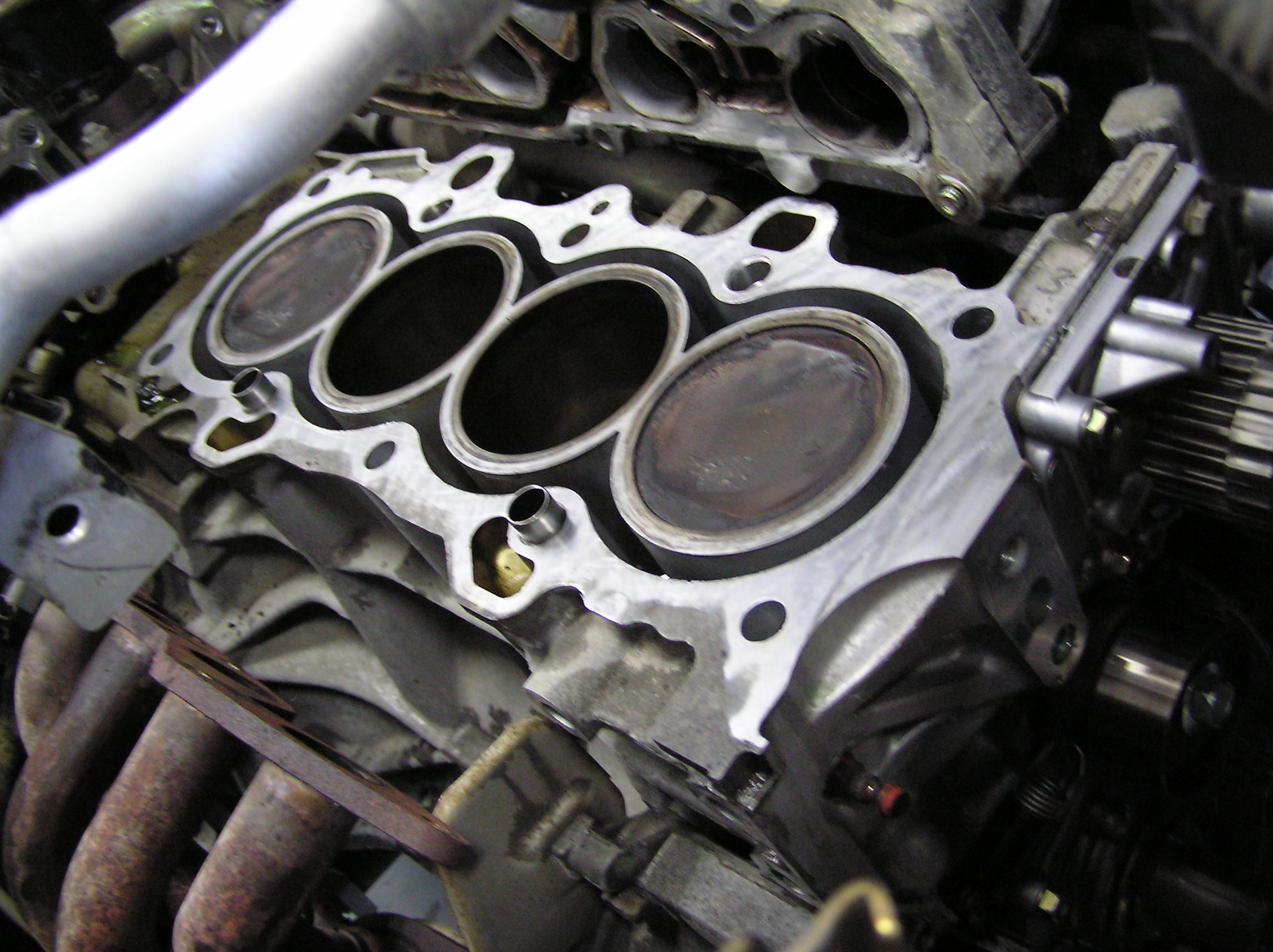

So I got everything open but this is only my second head job so I dont have enough experience to really know what Im looking at so maybe yall can offer some opinions....
#1 - Does this head gasket look toasted?
(block side, cylinder #1 & #2)
(block side, cylinder #3 & #4)
(head side, cylinder #1 & #2)
(head side, cylinder #3 & #4)
#2 - Im not sure what this is but it looks like soot marks maybe from the headgasket leaking combustion gases into the water jacket. This is on the block side cylinder #2 & #3 on the water jacket(I might have observed the same thing in the same spot on the cylinder column in the water jacket but I dont remember for sure, I cleaned it so its gone now)...
#3 - Coolant in the oil(bad headgasket)? My valve train and cover have NEVER looked like this! Always very clean, never have I ever seen any black sludge in this engine...
#4 - What could be causing this sludge in the intake manifold...
(head side, intake)
#5 - Again, soot in the water passages. Also, you can see some corrosion near the mating surface at the top and top-right-hand corner of the passage. Any ideas?...
#6 - Also, there seems to be oil leaking from the bottom of the water pump. How is this possible? I know its not coming from above. You can see it if you look just to the right of the tensioner...
#7 - Do I need a new exhaust manifold gasket?...
#8 - Anything interesting here?...
#10 - There seems to be little valve cutouts on the intake side of the pistons which, when I search the internet for pictures appears to be on all D17A1s, however, there are also valve cutouts on the exhaust side but only on piston #1 which makes me think they might have made contact. Is this the case? I can take a picture if needed.

When was your last oil change? I would assume you would have noticed this sludge in the oil at that point. What's causing the sludge? Probably the coolant leaking into the oil. If you drive short periods of time it can make your oil thick and crappy looking too. Or if you're a fan of Lucas products. I know they say they can be used in "any engine" however I have not had good luck with using additives in hondas. (VWs on the other hand seem to love the stuff, as well as larger engines in general.)
Water is more dense than oil, so it's odd you have an oil leak out of your water pump, and not also a coolant leak. What's causing that leak? Well, if you have oil in your coolant (which it seems like you do since oil is leaking out of your water pump) then I would say you have a faulty water pump gasket which is leaking oil. I assume you drained the coolant before starting this procedure. Was the coolant contaminated with oil?
You should always replace any gasket you remove from the exhaust system. I always replace any gasket I remove though. I'm too OCD to reuse a gasket. Especially exhaust gaskets though, IIRC after a component has been used for 5 minutes, it's no longer new, and needs to be replaced if it is removed. Fasteners, gaskets and the like.
I'm curious if the misfires you've been having were leaking that sludgy oil back to the intake (that is to say if you have bad valve seals and the oil from your valve train is leaking to the combustion chamber, then a misfire occurs when the intake valve is open, thus blowing sludge, exhaust etc. through the intake.) What does your air filter look like?
Old Oct 14, 2015
  #55
I do my leakage inspections before teardown so I know exactly which cylinders need to be inspected once it's apart. Um, yeah it looks bad. Sure.
You have a crapload of sludge, and coolant in the oil is not a usual symptom in the early stages of HG failure.
AFTER it's been overheated enough to distort the gasket and warp the head and let coolant into the cylinders or oil return holes it can happen, it is anyones guess as to how much damage occurs and what all mixes.
It's may be the result of some combination of coolant mix, oil breakdown, lack of maintenance, lower quality oil, and overheating. Take your pick LOL.
Water pump.......maybe the oil leak came from above it and ran around the outside of the pump housing to the bottom where you saw and questioned it. Gravity in effect. There's a whole lot of mess below it around the crank gear and the pan.
Or maybe it's sealant someone put on it...I know Aviation Sealer makes a brown stain.
Intake ports: Normal IMO
Carbon buildup in the intake and ports is normal, as is oily residue. EGR and PCV both contribute along with pulse and reversion effects.
Was it determined that coolant was entering the cylinders? Could be from that.
If it's ever had Seafoam/cleaner/snake oil ran through the intake, it could be a result of that too.
That's not soot in the water passage, that's one of the EGR passages in the same housing. Even if the engine has no EGR, the passage is still in the head and it is open to the exhaust so it can collect carbon.. Normal IMO
About 7,500 miles ago. I have always used Mobil1 5W-20 Synthetic. For the last oil change I used Mobil1 5W-20 Synthetic Extended Performance. Like I said Ive never seen this sludge before. I do the valve lash adjustment on schedule and the valve train is always super clean. Like I said before I did notice some sludge on the dipstick I had never noticed before.
Never short on this car. This vehicle is specifically for my wifes long-distance hwy commute to work 3 times a week 2 hours round trip.
Thats why I was confused about it, otherwise I would have just changed the gasket and not mentioned it at all. Ill be pulling the water pump tomorrow so Ill know more then.
Didnt look like it at all but does that mean that the oil isnt contaminated with coolant? Can one be contaminated and the other not?
Thats would be great if thats what it is since Im having a machine shop go through the head. Air filter looks fine. The throttle plate had some oily sludge crap on it though. Was splattered.
Car is maintained very well. Oil has always been Mobil1 5W-20 Synthetic. Have never let the temperature gauge peg out or even reach the red line but its been very close a few times. I noticed when I had the ScangaugeII on it which shows you actual temperature, that even at normal operating temperature(according to the gauge) the temp was around 220F. Normal operating temp puts the gauge needle just below 1/2 way or about 3/8. When the needle got to around 3/4 of the range the Scangauge was telling me it was around 250F! That means if that thing is pegged out or close to it, then what is it? 280F?! That seems like a lot.
No. Not the smaller passages on the bottom right. The big square one on the left with my finger next to it. The finger with the soot on it I gathered from that square hole passage.

So do yall think that head gasket was shot based on the pics?
What about question #2? Those soot marks?
Any info on question #10? I couldnt find any pics of the exhaust side of the pistons on a D17A1 opened up.
Yes.
Oooh I didn't realize that's what you saw.
Sediment? Cooked coolant? Rubber?
Clean it and go on.
Is there any goo in the neck of the radiator?
250+ may be enough to boil the antifreeze and steam erosion could ruin the inner ring of the rad cap area, causing it to not seal and hold pressure correctly. May as well check that.
~225F is the boiling point of 50/50 antifreeze mix---at atmospheric pressure. Raising pressure raises the boiling point, but if the systems ability to hold pressure was compromised.... that's bad.
Does the top radiator hose crackle when you squeeze it? That would be bad.
I dunno. Not sure it's anything to worry about.
Would be nice if you knew which cylinders were leaking.....The more you know, and all that.
If the head turns out to be warped, then you might speculate it's from combustion leakage and a very low liquid level inside the block.
I think the relief cuts are in the intake side (been a while since I've had the head off of one).....but I also think that whatever you found is how it's made --- if they are covered in carbon.
If any valves got bent, the machine shop should find it when they do a leakage test. And you'd probably have fresh clean kiss marks in the piston where it hit if it did make contact (contact usually knocks the carbon off where they hit).
And you'd have to really screw up to do it yourself, like try to spin the crank after the timing belt was removed.
I don't remember if this is from an A1 or A2, but it's a D17 of some sort LOL
Oh wait, it looks like a header so it must be an A2 engine.
I think those pistons are D17A2(VTEC). Mine isnt and they look different. Heres a picture of MY pistons (D17A1). You can clearly see the exhaust valve "tick" marks and these marks arent on any of the other pistons, only piston #1 which is what made me question it at all since all 4 pistons have the same tick mark on the intake side bit not on the exhaust side.
On a side note, what do yall think of my harmonic balancer? Its got some chipping on the lip that carries the power steering pump belt. Should I replace the balancer or is this chip just cosmetic? Is it going to throw something off?
One more.
Heres a picture of my bottom end. I had to pull the oil pan because it was leaking everywhere. Im already going to pull the oil pump and pickup screen to do the seals and check the pump for spec. Is there anything else I should while Im in here digging around? Should bother trying to clean the sludge in here? It would be a real pain in the *** and its not nearly as bad as the intake runners and cylinder head. I was going to run some cleanup solution through it anyway when I get everything back together. Good or bad?
Crank looks good IMO. You could do an oil flush though. Fill with cheap oil, run for 10 mins once at operating temperature, then drain. Refill with the oil you normally use. Change the filter after you drain the cheap oil.
Are the valves bent? Are you having the heads looked at by a shop to check for warping? If so, have them check to see if the valves are bent. If your valves are straight I wouldn't worry about the notches in the piston.
Just make sure you time everything correctly when you reassemble.
I would replace the harmonic balancer pulley. That could affect the balance of the engine, add extra stress on the crank, cause improper functioning of the accessories it powers, etc. I've seen crank pulleys so out of balance they shear the woodruff key and splines on the crank and start spinning independently of the crank.
