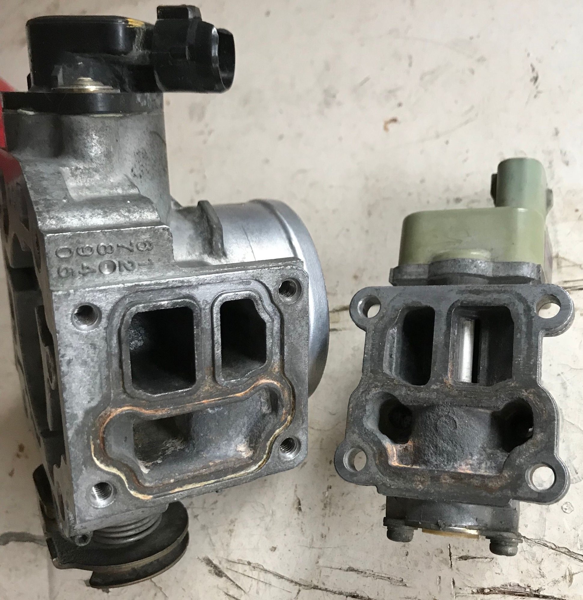

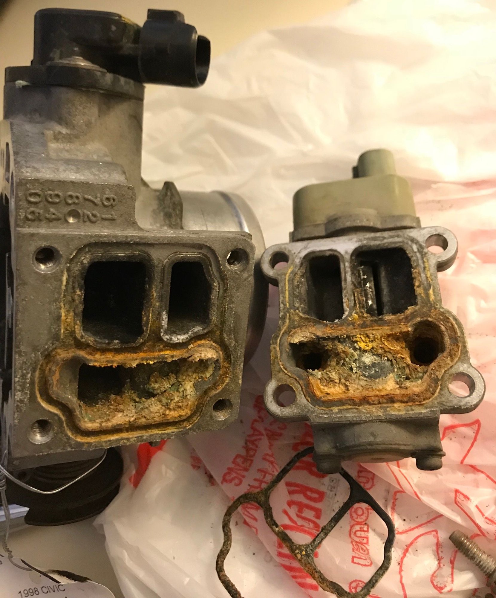

I separated the IACV from TB that I bought at salvage yard; so I can clean it and WOW...can’t wait to see what the one on my car looks like.
I bought a new TB gasket, IACV o-ring as well as throttle body & air intake cleaner, with which I plan to use a cloth shop rag and old toothbrush to clean both parts.
That said, would you spray and let soak first, then clean or scrape some of the corrosion off first, then spray?
Old May 14, 2019
Colin42's Avatar
Posts: 9,654
Likes: 1,285
From: Barrie, ON Canada
Rep Power: 223
Re: CEL came on while driving...
Try to get as much off scraping first, if it's not coming off easily then soak it
Old May 14, 2019
g4384063's Avatar
Joined: May 2015
Posts: 108
g4384063 is an unknown quantity at this point
Thanks!
Scraping first seems to have worked pretty well...
Old May 14, 2019
Colin42's Avatar
Posts: 9,654
Likes: 1,285
Rep Power: 223
Looks way better, make sure you bleed all the air out of the cooling system
