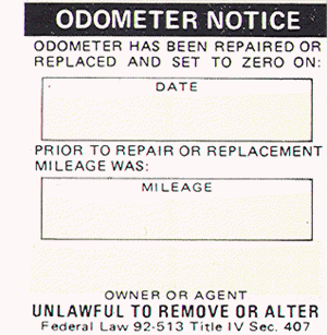

Cheapest and definitely legal: Go to your local DMV and see if they have any of these stickers
Or maybe a car dealership....I know our shop USED to have a stack of these
To actually change mileage in the cluster you would have to send the cluster out to a speedometer repair shop that has the electronic equipment to do the work.
There are several around the country, we have used http://www.paspeedo.com/
In my state I think the DMV doesn't give a poop once the odometer is over 100k.
