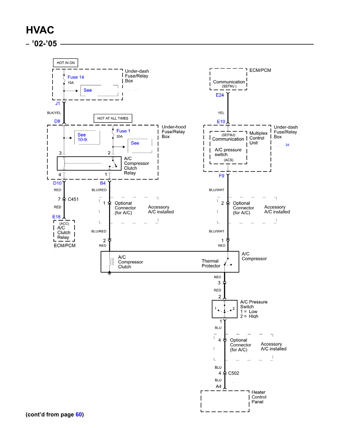

Old Sep 29, 2017
Re: A/C electrical gurus unite, The dead horse that needs beating
Unghosted your missing post.
Yeah I can and do write super long replies too, but I didn't have time to sift through half a service manual and filter out the important parts.
THIS IS WHERE IT GOT WEIRD, jumped the two terminals, the condenser fan comes on but compressor clutch does not pull in.
Wrong relay, you missed the clutch relay.
The clutch relay is usually represented by a simple snowflake. The condenser fan relay is shown as a snowflake within a rectangle.
See this pic:
In this particular image above (googled),
R1 = radiator fan relay
R2 = compressor clutch relay
R9 = horn relay
R8 = condenser fan relay
Pretty sure this car is just a late 2001
Then you have a 2002.
Check your VIN against a chart, the 10th character is the model year.
LINK: https://www.dmv.org/vehicle-history/vin-decoder.php
Ok so anyway......I know how it's supposed to work, so I can skip most troublecausing-charts and simply observe the processes to determine what is present or missing.
Answer this:
(NOTE, the blower fan in the dash MUST RUN or else the control panel disables the AC system)
You turn on the fan and push the AC button on the dash....
You said the compressor does not turn on
Do both radiator fans run when you turn the AC on?
If no, ignore the rest of this reply and let me know...we will go on a different path.
If the radiator fans did turn on, that tells me the system has sufficient pressure to allow operation, wiring for the 'AC request' circuit is intact from the HVAC control panel through the pressure switch (and thermal protector on 2002 and newer) and back to the MICU and PCM, PCM "sees" the request and should have turned on both radiator fan relays and compressor clutch relay
so I know I need to focus strictly on the circuits involving the compressor clutch relay, the clutch and coil, and check mechanical issues with the clutch assembly.
I use a long screwdriver to check for the presence of magnetic field at the clutch hub. If the screwdriver is attracted, I then push hard on the hub to see if it engages against the spinning pulley.
If it does, then the air gap is probably far too large.
If it did not engage or field was not present,,,,,then check:
Engine running, AC turned ON:
I remove the compressor clutch relay.
I feel for it to click as I remove it, that indicates its coil was energized with power and ground because the PCM turned it on.
I then check with a simple LOW wattage 12v test light:
I must find 2 powers and 2 grounds in the relay socket. If one ground is missing, that's probably an open field coil. (actually should be somewhere around 3.5-4.5 ohms if you want to check that from the relay socket)
If coil is not open nor excessive resistance, then jumper the 2 larger terminals in the clutch relay socket to supply power to the field coil: Does it click?
If no, then check for excessive air gap
I dont know what I was thinking here, I jumped the two wires at the 3 wire plug at the compressor for some dumb reason, that caused the fan to come on, when I jump the relay the clutch pulls in.
Everything on the inside functions as should, ran the a/c DTC and got no codes.
No, and I checked the low pressure switch on the drier and it is closed.
I also checked the Clutch relay you have labeled as R2, the way I did this was to to pull the relay, if looking at the relay socket from the front of the car, you have to horizontal terminals, and two vertical terminals, the verticals being one and two that you jump to pull in the clutch, the other two, the horizontal closest to firewall has 12v, so I ran a wire from the horizontal socket on the radiator support side, pushed the relay back in, then grounded my jumper wire, the clutch pulled in and the compressor came on, suction pressure around 40psi but head pressure was going up and fan not kicking on so i removed my jumper wire. what sends the ground to the clutch relay to close the relay?
If I'm not making sense, let me know and I will try and grab some pics tomorrow.
Old Sep 29, 2017
Combine this answer with
Your thermal protector is probably open circuit. Ohm check that.

No dice, compressor thermal switch checked out, jumped it on the wiring harness side of the connector incase there was a pin issue in the connector, still no action on compressor clutch.
Old Sep 30, 2017
You jumped the two outer wires, yes?
Earlier you said this made the radiator fans run....so does this still make the fans turn on? (with the HVAC controls set to fan on and ac on)
Do you have a wiring diagram for the AC on this car?
Reasoning: The "AC request" occurs when the HVAC control panel grounds the request line, which mus pass through the closed contacts of the pressure switch, the closed contacts of the thermal protector, to the MICU---- and then the MICU converts that to data and sends it to the PCM.
When the PCM sees the AC request data it then turns on both fan relays and the clutch relay at the same time.
So when you said you got the fans to kick on by jumping the wires from (what I assume to be) the thermal protector, I assumed that part was or is open circuit, interrupting the AC request.
So I would check if the PCM is turning on the clutch relay (supplying ground to the relays coil) at the same time you make the fans kick on.
The relay coil is supplied with 12v+ from (some fuse) and the PCM controls the ground side. PCM output drivers can't handle much load (like less than one amp), so be careful, a short can knock out the PCM.
Also..a GOOD scanner may be able to display the AC request status, the AC clutch relay and fan relay statuses in a live data list. That data is sometimes immensely helpful in troubleshooting.
Old Sep 30, 2017
hkp's Avatar
hkp
Joined: Sep 2017
Posts: 11
hkp is an unknown quantity at this point
I jumped the red wire on the outside to the middle wire, not outside to outside.
I'm starting to wonder if the A/C panel is broke and its not sending the ground, if I check the at thermal switch to ground or the pressure switch, would that let me know if the HVAC control panel is sending that signal?
Old Sep 30, 2017
Oh. ****. No bueno. OK now what happened makes a little more sense.....
The two outer wires are for the protector, the center wire is for the clutch field..
the center pin, IF it was still connected to the compressor clutch field coil, provided sufficient ground to the request line that the PCM turned on the system.....Maybe. I can't tell how you did what you did though.
UM.... yes.
The "AC request" is simply done by grounding a circuit in the control panel, and that's supposed to make its way around to the MICU......so you should be able to go to any of the items in that circuit (pressure switch, thermal protector) and see if it is grounded.....as long as all items are connected and have continuity. I usually want to backprobe to take readings so I can check with everything connected, in-circuit, live and working.
Real simple AC diagram pic found on goggle search:
In a nutshell, everything between heater control panel and multiplex unit (MICU) is the AC request line and is done with ground.
THE control PANEL is known for failing--unable to supply a ground to the request line. IF this is so, you can pull the panel and provide ground to the blue wire on terminal A4 and the system should run.
The short line that is labeled "communication" is done with data and there is no simple way to test it with a meter.....but it's OK on your car....because you got the fans to kick on.
