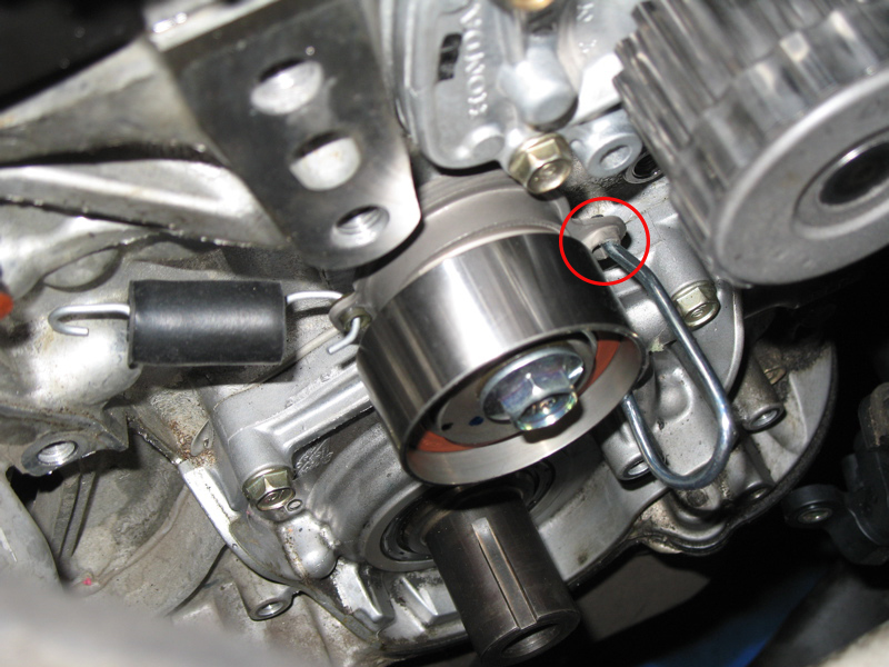

It turned out that I had mounted the tensioner on the wrong bolt hole
how the heck is that even possible?
there is only one hole there that i know of

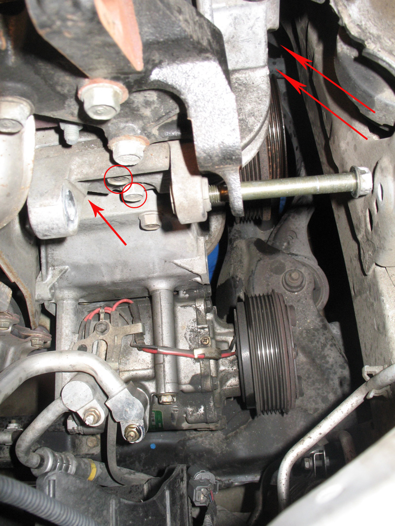

Old Sep 15, 2017
Re: Trick to Getting Timing Belt On?
The holes for the big L shaped bracket

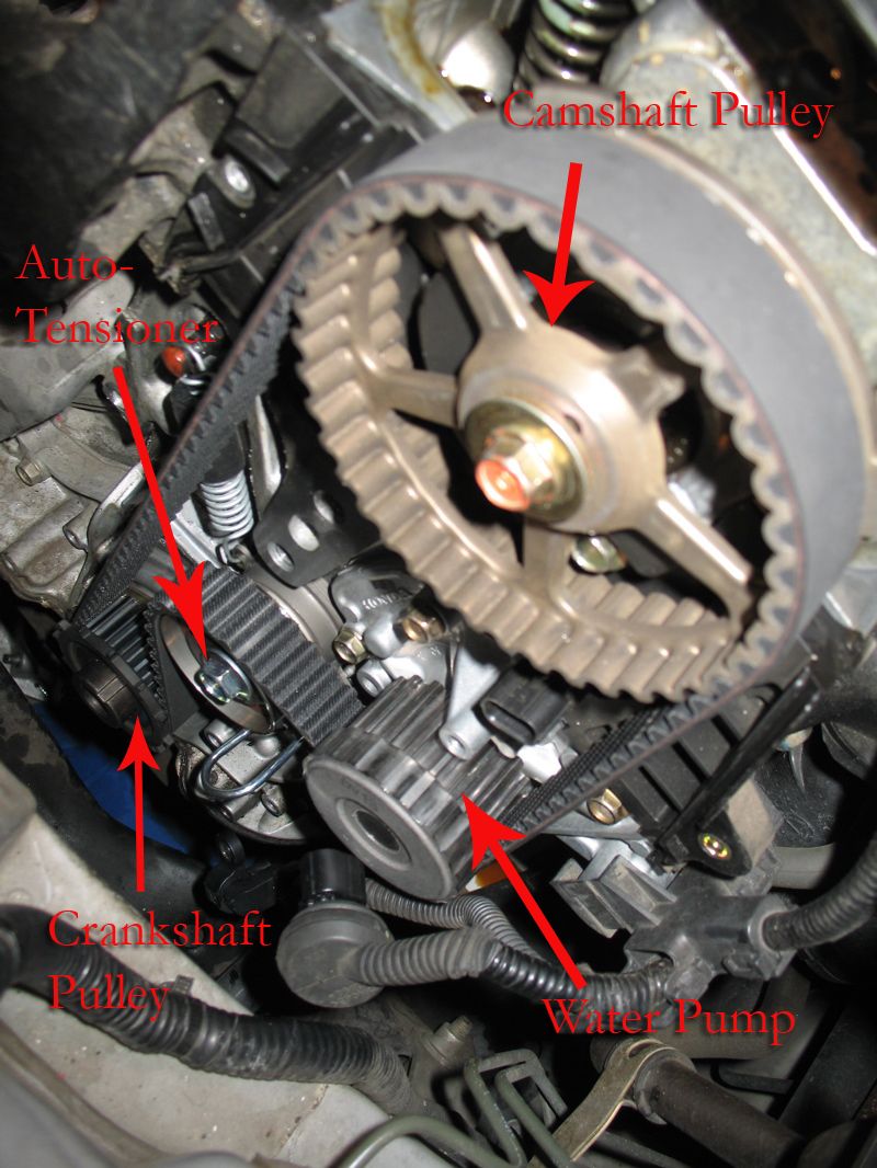

ezone has it. Here are the photos from https://www.civicforums.com/forums/1...t-diy-2-a.html that show the alternator bracket's bolt holes above the tensioner. It was a lesson in being tired and working outdoors, with the sun going down.
I think I need to set aside three days, in a dedicated space where I can lay out all the parts in order as i remove them, with a coffee bar and frig on the side, next time, given my age. My condo does not have a garage. I have to borrow space from friends. Not good.
I appreciate everyone's input. I am glad I once again did my own timing belt et cetera change. Yet I could not do it without forums like this.

Old Sep 15, 2017
mikey1's Avatar
Joined: Mar 2011
Posts: 2,499
Likes: 5
Rep Power: 211
LOL....okay,
but thats not even close to where it should be
