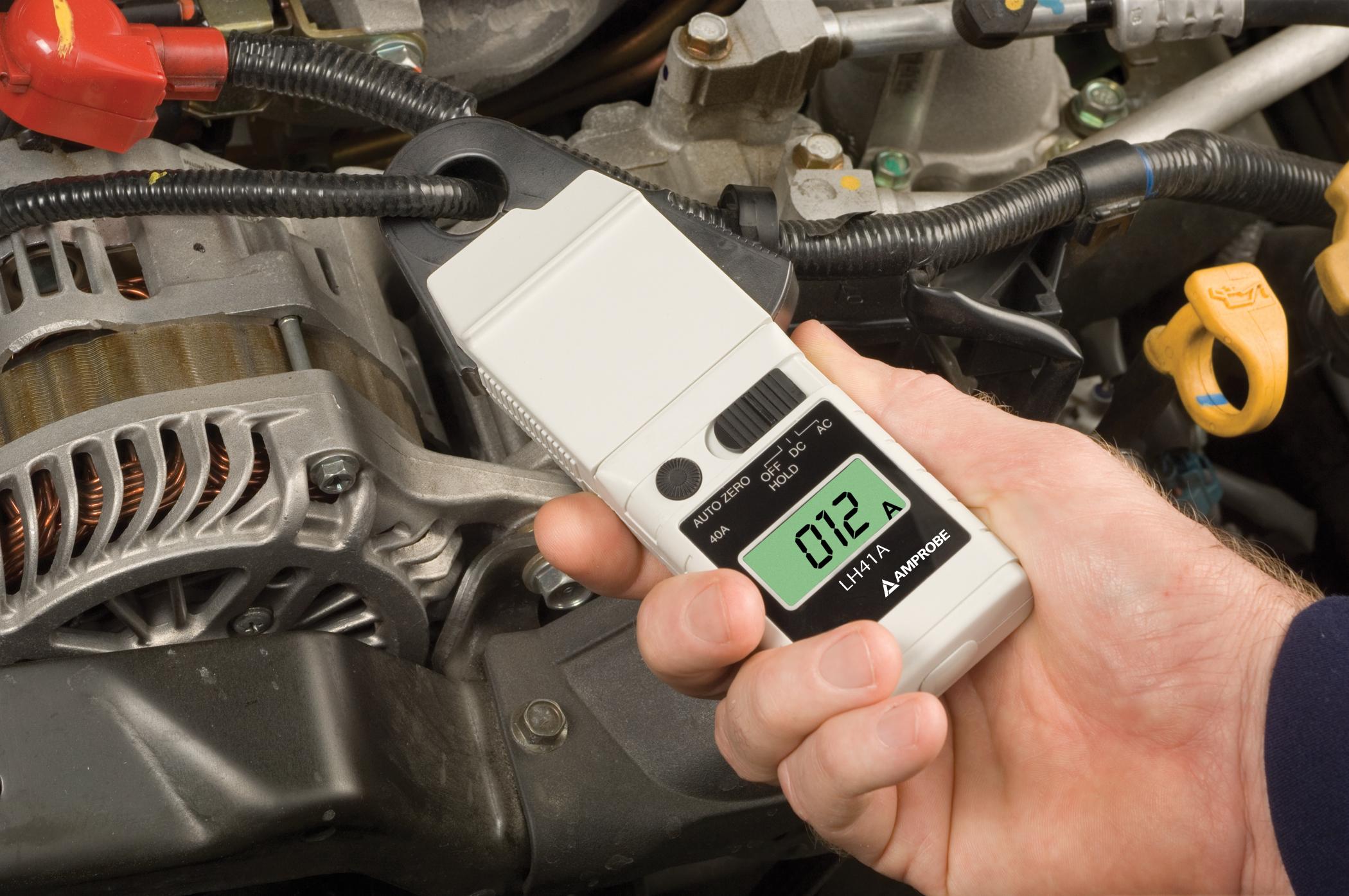

Simple: Disconnect that switch again, see if problem goes away.
I have a couple multimeters with ammeter function, but they take too long to set up.
For speed I use a low current inductive (clamp on) ammeter to measure draw.
This one:

So then you want to hook up a low current ammeter of some sort to measure the draw.
If it's within a normal range, no problem. (I'd consider 30mA or less normal for that car, 100% stock) Look for a low charge/weak/sulfated or failing battery
If draw is excessive, you have more work to do.
