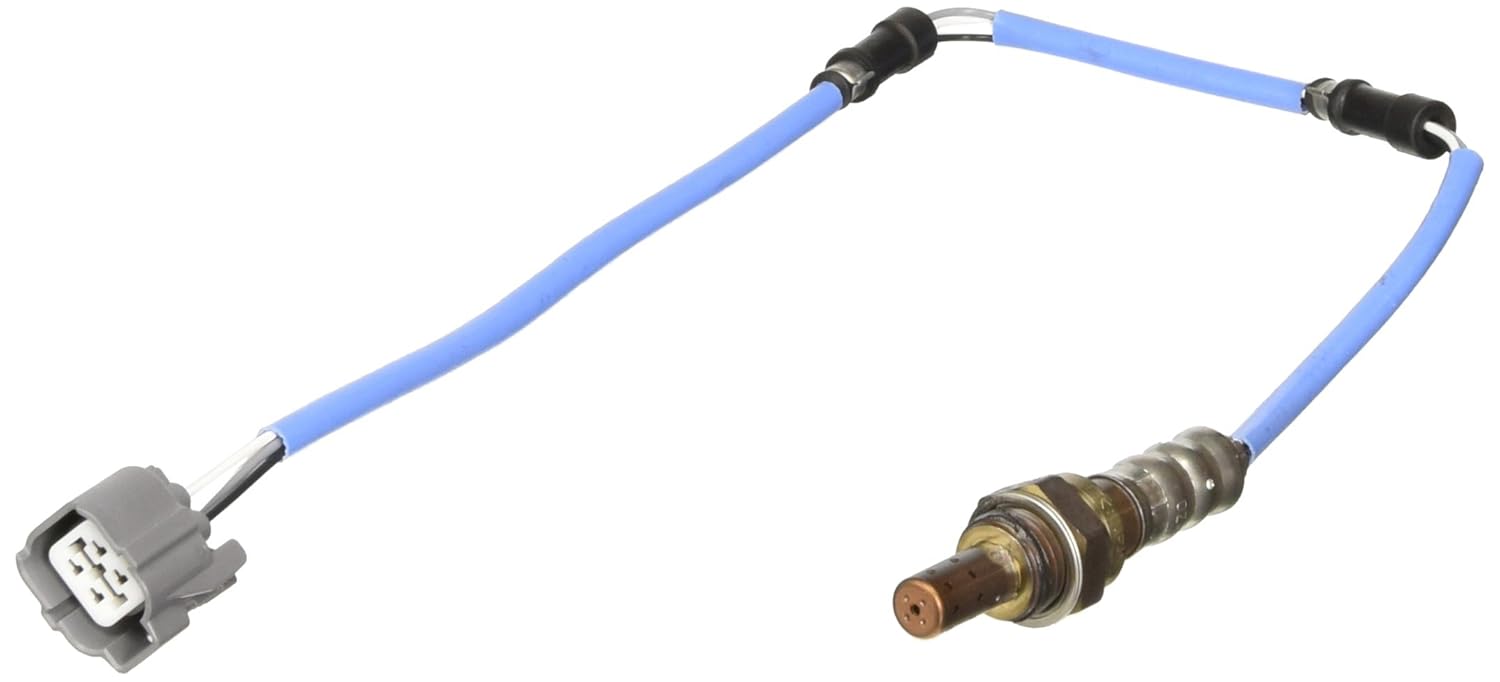

Alright I looked at it, couldn't see any serials, both of them have blue wires
Looks like this from amazon the NTK #24243
https://images-na.ssl-images-amazon....L._SL1500_.jpg
The Denso looks like this:
https://images-na.ssl-images-amazon....1HWRKUQnNL.jpg
Would it hurt to just buy the NTK since that's what it seems to be or should I make sure?

I'd go ahead and get the NTK part. It looks like (your pic) it even comes with the correct rubber pads in the middle of the wires to fit into the holders on the car. (surely you saw those holders while you were under it)

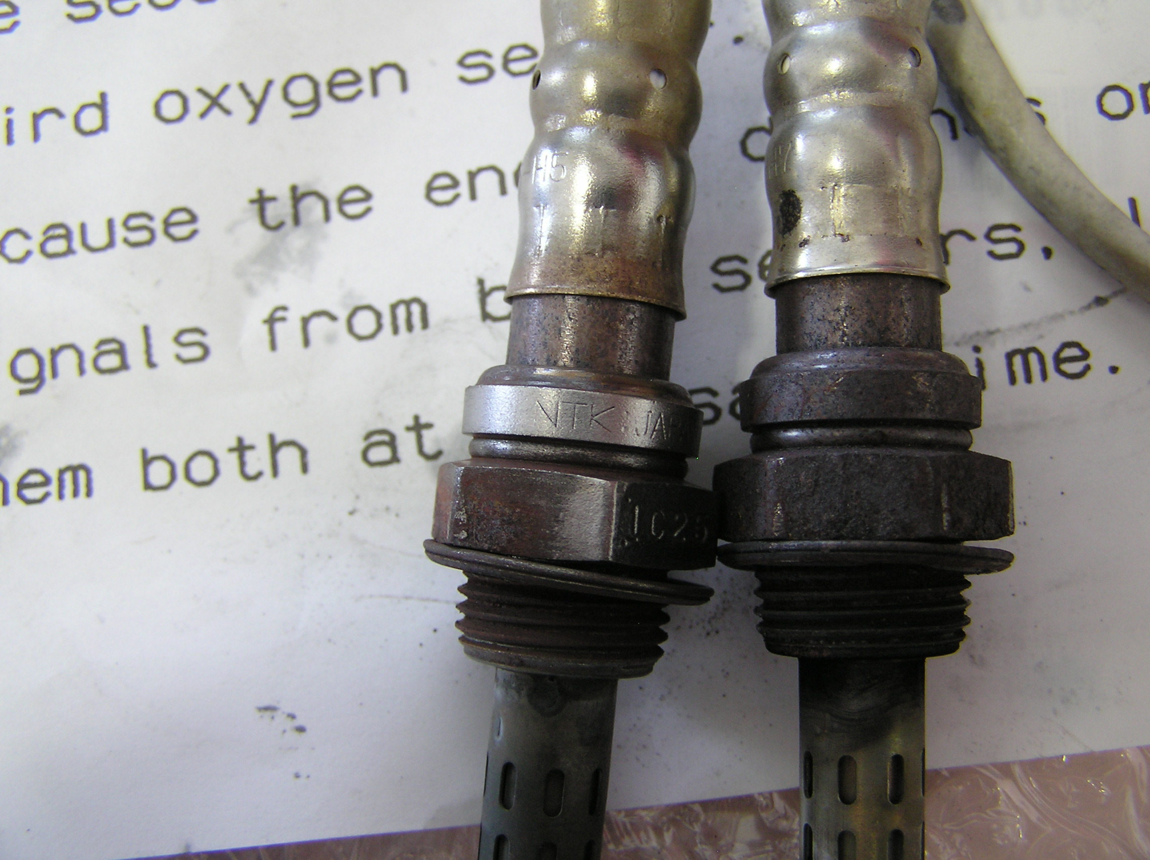

You'd have to remove the sensor and look closely at the shell for the name, or use a wire wheel to get the corrosion off so the name can be read on the steel if it's there.
Pic here is of a pair of sensors removed, one I held to a wire wheel to clean the rust off and expose the brand name on the ring above the hex
