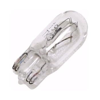

or a simple #194 light bulb with the two wires straightened out as a test light.
If it lights up, you have power and ground so the accessory socket must be bad (might have a bad fusible link on the back of the socket). If the test light bulb doesn't light up, more checking is needed.

Take an ordinary #194 light bulb (commonly used for license plate light and park lights)
straighten out the two wires at the base and insert one wire into each of the two terminals in the connector from the power outlet. Turn on the key and see if the light lights up.
If it does light up, you just verified that connector has both 12v positive and ground.
If so......Problem has to be in the power outlet itself.
