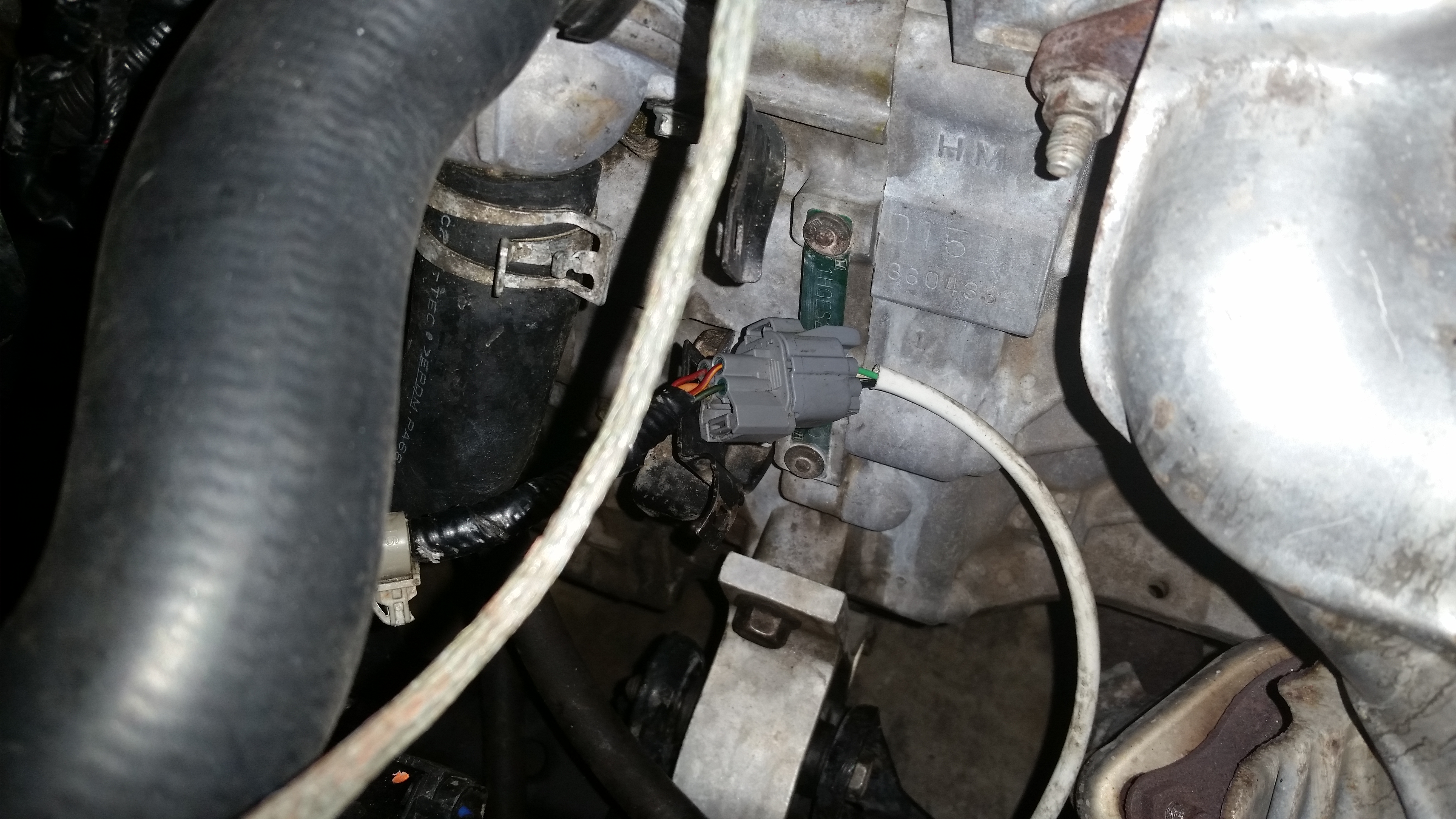

So the code I am getting is p0335. Here are the symptoms. After I reset it I started driving. When it starts to switch gears it starts to stutter and eventually the light comes on. I reset it again. same thing trying to switch gear it started to stutter. Reset it one more time and I could not get it to come on again. I tested the sensor plug and had all the right voltages. It is almost like a vacuum issue on the transmission it seems like. I attached a picture of the connector that I think may have been causing it. It got really wet when I had my thermostat leak. I see that this cable goes to a sensor in the exhaust system and wondering if this is the problem.
P0335: crankshaft sensor circuit no input
Did you plug it in?
The connector you pictured is for the O2 sensor

Yes it is plugged in. Like I said the car eventually will drive without an issue for a while and no code comes in. I drove it at least 20 minutes, hard, after I reset it the third time and could not get it to come back on. I know tomorrow when my son take it back on it will come on again. I guess I need to check the voltages again to make sure that there is nothing in the connector that is broken that every once in a while.
This is a picture of your O2 sensor wire harness connector. Upstream is the one you see at the exhaust manifold. Look below for downstream sensor. You can follow the wires. But that isn't related to a 0335 code...
You replaced Crank Sensor... where did you buy the new sensor? Is it a bosch? Is it a genuine Honda sensor?
