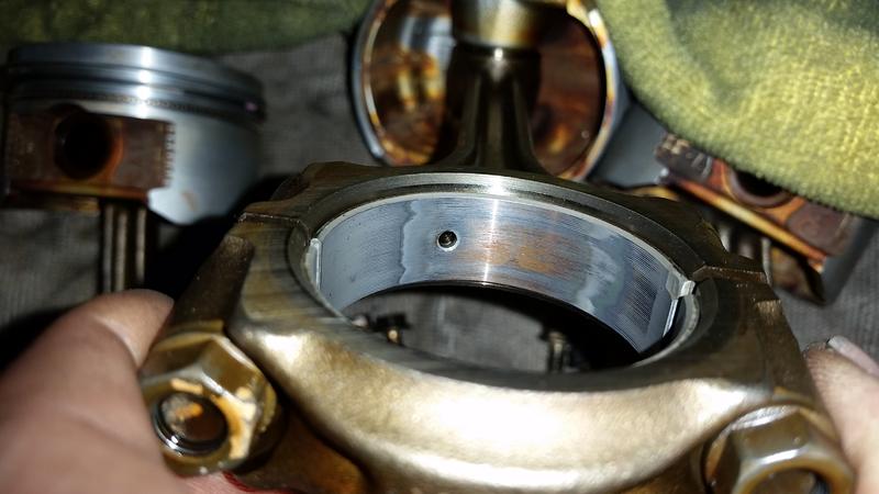

Good call on the rings they are disgusting ha ha. That was sound advice. Now I'm noticing wear on piston 2 and 3 connecting rod bearings, slight but visible. According to my Hanes book they chalk it up to lugging wear. Is replacing the bearings as simple as pop the old ones out and slap the new ones in? Also is that a sign to pull the crankshaft and check those? Where do I draw the line on this Thang
Some wear might be expected, it does have a bunch of miles on it.
Got pics?
Was it noisy, as in rod knock noise? If no knocking noises, I'd probably reuse them. If they weren't a problem before, then it shouldn't be a huge problem now.
You could plastigauge them to check oil clearances if you are real concerned...
Original bearings were select-fit and IMO a PITA time consuming process to do.

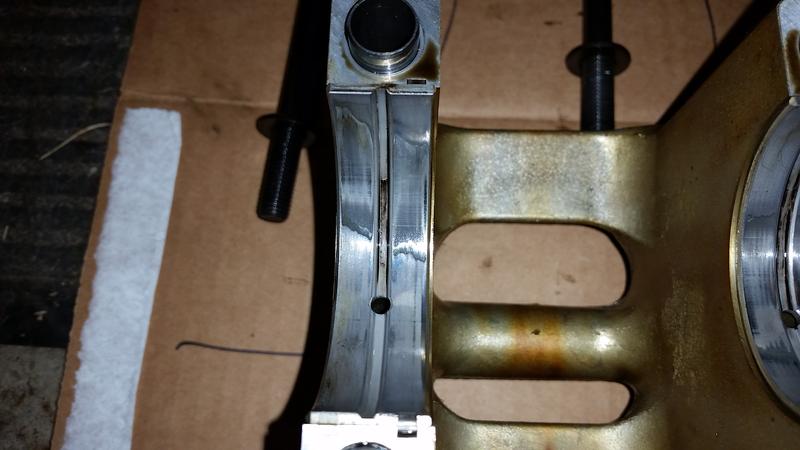

I think these have the most wear. Not sure about the noise it was missing pretty bad but I only listened to it odor for a couple minutes than started checking spark and fuel and found the dead cylinder. I don't recall hearing a knock or anything but I want really listening for it either. ..

IMO it's up to you. The upper shell of the bearing looks questionable from this angle, but it WAS running on it.
Your miss was on #4, not these. It was running with no complaints (other than the miss) when you took it apart, so it should (will) run again when you put it together.
OTOH you could slide in a set of rod bearings if you want. Price a standard (I assume) size set from your local (quality) parts store or machine shop?
Do the plastigauge for checking oil clearances?
Wanna go for mains too? All the mains that are easy to reach without pulling the crank all the way out? (I've done this)
Did you take the main girdle off, can you see the bottom halves of the main bearings?
If you had not pulled the pistons out to do rings, you'd never know it looked like that....and it probably still would have run a (potentially) long time like that.

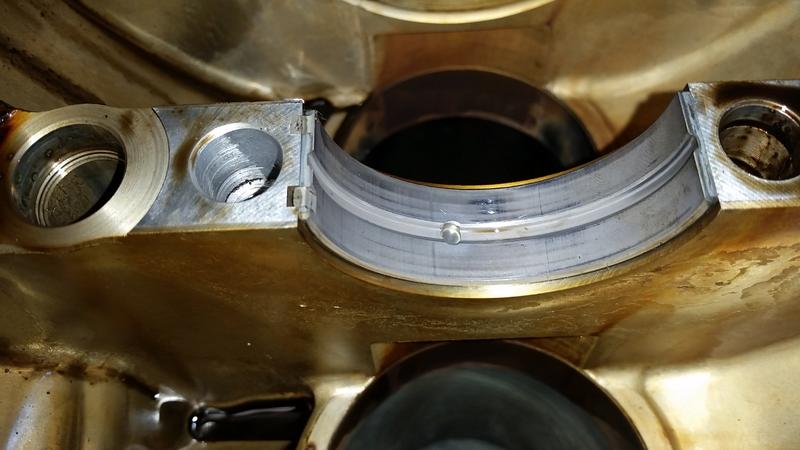

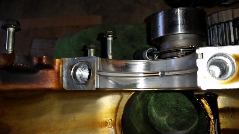

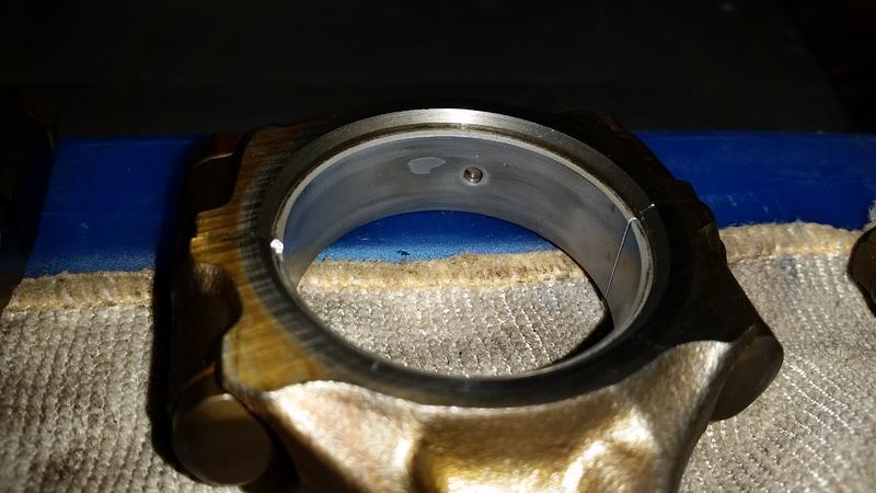

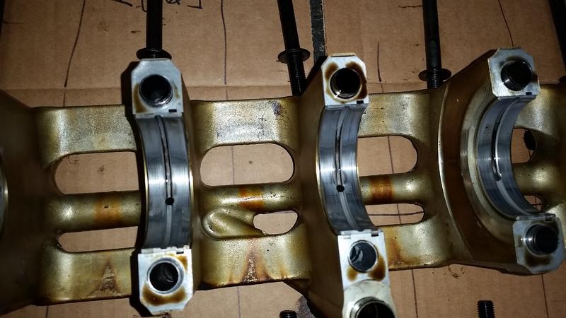

Well after some consideration I've decided just to go ahead and replace Conrode bearings along with main and thrust washers. I'll send then crank off to get miced and possibly turned/polished. It's another 200 bucks but hey we've come this far rite might as well. Plus new experience I guesse. I was wondering if you see in your service manuel of it calls for new hardware in the main caps?
Old Apr 2, 2015
Re: 03 180xxx burnt valve questions
I see no mention of replacement.

This is actually kinda fun. Makes me want to do my bimmer next, 89 750.... second thought maybe not ha ha

Ha ha this must be the pita thing you were talking about. ..
let me ask you this. .. had the crank buffed as they said it didn't need to be ground and they recommended orange colored main bearings wich as I believe are the original size. After plastigage it looks dead on at .002
so that's not going to work is it?
Using the green plastigage btw
Old Apr 14, 2015
So what do the journals measure at now?
.002 puts you at the max end of the wear limit, so technically it's acceptable....but it may not sound like a sewing machine LOL
Check the crank and block markings to see what the originals were?
IDK...It's not a brand new engine by any means.
