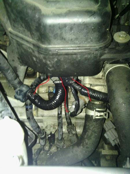

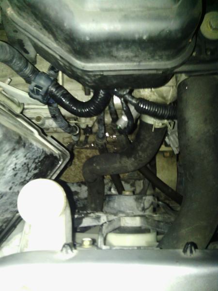

standing in front of the car

Looks like where antifreeze would spray when the reservoir overflows with force...... There should be a small vent hole in the side of the reservoir cap, it was probably aimed where the mess is when it overheated.
Sometimes they will soak the battery, sometimes they soak the fan shroud. All depends on where the hole was aimed.
At least I HOPE that's what happened and there isn't really a leak coming from that area of the engine. You'd need to investigate more to find out.

red lines are where i saw the water coming out, i only had a flash light though

I just see wet wiring and a ATF cooler line. The only thing that has antifreeeze nearby is the radiator hoses and the reservoir. I suppose a radiator hose could be spraying like from a pinhole, but you should probably notice if it is pissing a stream of fluid out when it's hot and under pressure.
lower radiator hose: That clamp looks a bit low, like it needs moved up because it's sitting on the barb. Maybe?
EDIT: I can see the fan temp switch next to that hose in the stat housing. It looks connected, but that's where to use the paper clip jumper.
