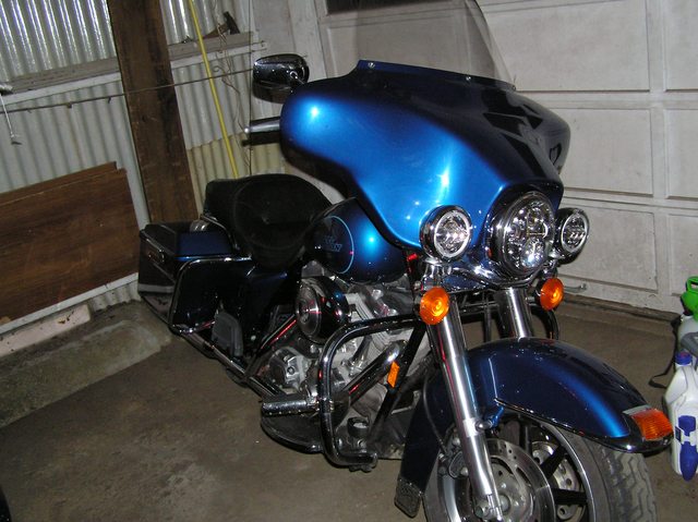

Here's my current girlfriend:
^This loudass money sucking bitch needs another back tire real soon, might try a Michelin this time....
