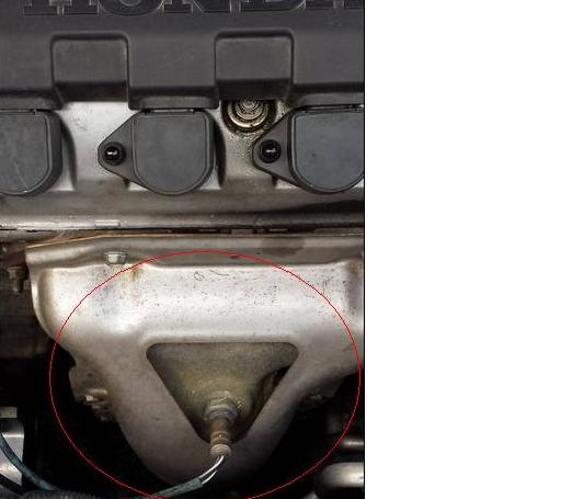

I notified them that when the car stalled, the "manifold" (picture) was "orange" and "hot".
Should this manifold turn "orange"? It's like placing a metal in a flaming fire in which you can bend it to any shape. I have never seen do this before.

What would cause this manifold to turn "orange" on "hot"?
A catalytic converter will overheat when sufficient raw fuel enters. Could be misfire, could be running far too rich, could be many causes.
Could be what I mention at the bottom of this post.
The cat may or may not have suffered damage. If it is damaged, there will either be a serious performance problem or a cat code P0420.

I'll guess they want to replace the cat for that price, that's about the 3rd most expensive thing in the car.
A damaged cat should never be replaced until after the root cause of the failure is known and corrected, if possible. A brand new cat can be ruined in a matter of only minutes if the original problem is not fixed.
$2000 is awful steep for not even solving the original problem. Or maybe this price covers that too, you aren't clear on this.
I wouldn't replace the cat unless there is a proven problem with it now.
