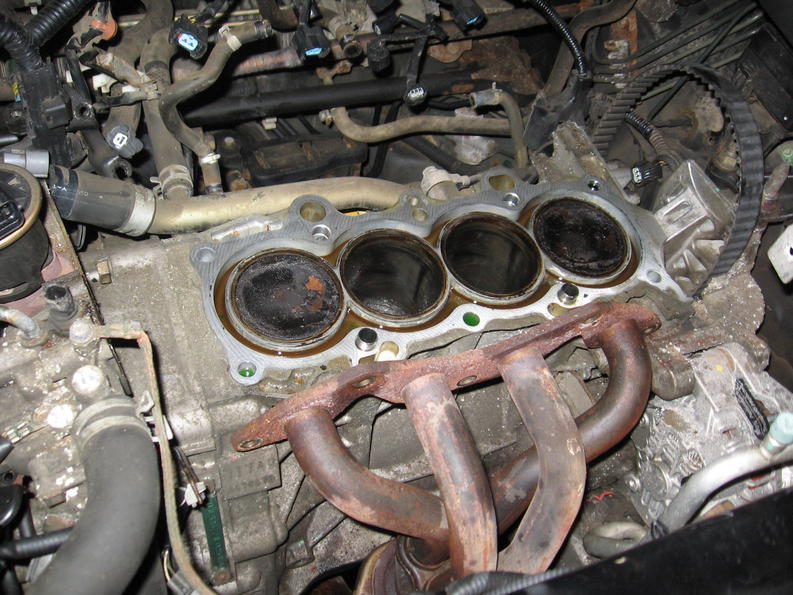

I'm in the process of replacing the head gasket in my cousin's '03 Civic, when I pulled the head/intake mess off, the dowel pins stuck in the head, and then abruptly fell off on the floor before I could verify which holes they went in. I am pretty sure the one on the right is in the correct position, but I wanted to throw it out there to see if anyone knew for sure before I stuck the head back on and ended up on a wild goose chase like the guy who wrote the sticky did. I'm going to try to attach a pic.

Lay the head gasket back over it. the dowels should only fit through the head gasket in 2 holes.
I think they are in the right place, but the gasket will tell the story.
(CHECKED: Diagram shows the same. Dowels on the exhaust side of the block.)

I thought about that, but the gasket that was in there had holes big enough at all options. I did grab the new one and set that on the block, and you're right, the dowels only fit in the exhaust side. Thanks for your help!

Definitely right

Thanks guys, it's all back together. The only regret I have is following the Mitchell instructions putting it back together and installing the intake after the head was back on instead of putting it back as one unit. I pulled it together, and I sure wish I would've put it back together that way. Thanks again!
