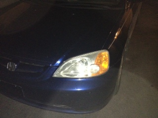

Im confussed, I see the bulb and see the wire but they dont work and it failed inspection for them not working. Im going to get a pic real quick and post.

Old Jan 2, 2013
Re: Catalyst System Efficiency Below Threshold
Bulb #6 is a marker light. #194 bulb available at any parts store.
Comes on with park lights. It is not a DRL.
Then it must just be the bulb! (light goes on) hehehehe
Thanks Dude, will pick up two tomorrow. Tried taking headlight fixture out earlier but was dark and cold out and gave up after the other stuff I did on the car, two bolts at top and seen on Majestic there was another at the bottom I didnt see.
Old Jan 2, 2013
You would have to take the bumper cover off to remove the headlight housing IIRC.
Those sockets WILL come out without all that work.
IF you can't reach the socket from the engine compartment, try pulling back the plastic inner fender liner and reaching through in front of the tire.
Name:	photo.JPG light.JPG
Here is my light as you described it.
