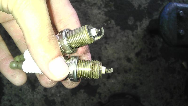

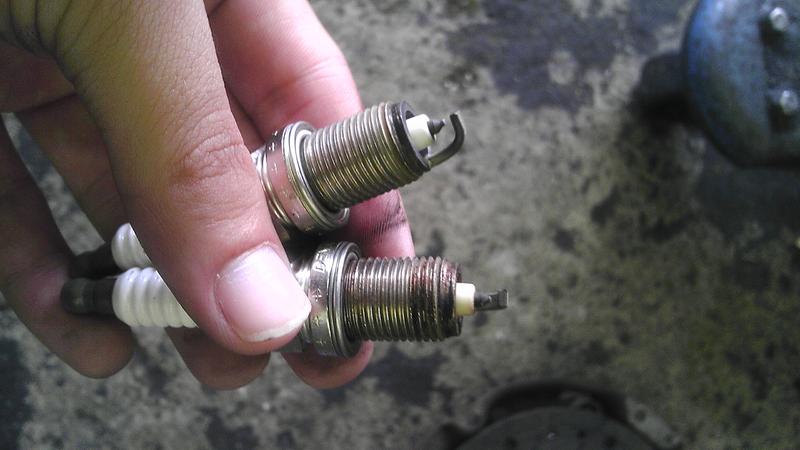

Sounds like a plan. I'll have my shop check the injector and do a compression test. I have been meaning to adjust my valves so maybe one of um finally went out? Idk, we'll see what the tests show and ill let you guys know.
Attached are pictures of two plugs pulled from my car. The plug on the bottom is from cyl 2.

Old Dec 6, 2012
Rep Power: 520
Re: Coil Packs
I don't see any issue with those plugs.
Made me think:
Carbon tracking on the outside of the plug porcelain and inside the boot of the plug wire end can act like this.
Example:
If this is what has happened, all affected items MUST be replaced at the same time.
One will cause the other in a very short time if only one of the parts is replaced.
If this isn't what is going on, then ignore this post.
