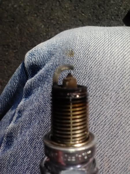

New ex manifold...now blue smoke from tp
04 Civic LX 170k, new motor (870mi)at 162k....
I had an ex manifold leak for, my best guess, around 3 months, had a new mani/cat put on the car and now after it sits idling/running for a while and I take off, a cloud of blue smoke pours from the back of the car.
I noticed about a week and 1/2 after the mani/cat work that the oil was low...turned out it took almost 2 quarts to bring it back to normal.
I also notice the car doesnt start as smooth/quickly, a slight hesitation before it fires up.
The gas mileage was much lower with the leaking ex manifold, and that is back to normal again....32mpg roughly
So what would cause the blue smoke? I havent checked for any error codes btw.

Re: New ex manifold...now blue smoke from tp
Trying to think logically here.....it was running fine with the cracked ex manifold except for the gas mileage issues.
The motor itself is newer than the other components. I am certain that I checked and added the oil properly so Im ruling that out.
What could have happened that is making the car burn oil now...Im guessing its not the ds sensor because the mpg has gone back to normal...does the computer need reset?
What could the cracked ex manifold have damaged if anything?
Yes the ex manifold/cat converter (all one piece) was replaced
New motor means the motor came from a car that was crashed but the engine was not compromised......side/rear impact, etc... the dealer it came from inventories motors and trans of 99 and newer cars...the motors are inspected/cleaned/stored in a warehouse. I bought the motor only...everything else is original to the car including the exhaust.
It was installed at a honda dealership and I had them inspect it before it was put in. I trust the dealership because I know the tech that did the work.
DS sensor=downstream exhaust sensor
The smoking smell is noticable most of the time but it can be clearly seen when the car is at idle for 5 or 10 minutes and then on take off a blue cloud blows out of the tailpipe.
Im taking it back to the shop that did the ex manifold job tomorrow..they did the last work to it before it started smoking.
Remember...It was NOT smoking at all before the manifold/cat was replaced
I guess I shouldn't abbreviate.....
When I say I had the ex manifold replaced, Im saying the exhaust manifold (ex)
The replacement part was an LX exhaust manifold/catalytic converter which replaced the original LX exhaust manifold/catalytic converter
The engine now has just over 8k miles on it. I was put in when the odometer read 162k, it now reads 170k. The oil has been changed and so forth as normal.
ds sensor, downstream exhaust sensor....again I am talking about the downstream O2 sensor but scratch that because I think I am meaning to refer the upstream O2 sensor which regulates the air/fuel ratio.
The oil loss/burning is definitely not excess or too much oil being filled and burning off... the oil has been brought to level twice in 2 weeks and is then going below normal.
If any more clarification is needed please ask...to me it makes no sense at all what is going on. I personally think it is an issue with a computer setting or a sensor not responding properly.
I doubt it is a major engine problem but I dont know. The exhaust manifold was cracked/leaking for at least 3 months, the check engine light was on and at the last oil change the tech ran the code and said it was the exhaust manifold that was causing it.
To sum up, the car was running fine minus the lower mpg with the cracked exhaust manifold/catalytic converter. It runs far better now with the new exhaust mani/cat converter but when the car is running at idle, like at a long red light, and then take off smoke comes out from the tailpipe. I can generally smell exhaust when I am just sitting, its faint but I can notice it where before I could not.
If it is a blown gasket I would be seeing oil right? I dont see any leaking oil from what I can see under the hood and no oil on the ground.
Trying to think of what is wrong that a new exhaust manifold/cat converter is making appear now where before it did not. Now it is burning oil and smoking...before it was not.
If the valve stem seals are damaged/worn/not working, why would they be? Did the running of the cracked exhaust manifold cause this to happen and now it is showing?
The oil has never ran low before, I have never had to top it off between oil changes and the oil has always been relatively clean. So, no it wasn't being burned off and not noticed before.
The mpg was improved immediately, I got 380 miles on the last tank from full to E light...and the car seems to run a bit smoother than before, in fact it runs perfectly aside from the oil eating and smoke issues.
I went to the shop that did the mani/cat job this morning and talked it over with him, his opinion is worn rings-oil is not being pulled out by the rings properly and burning up. Then I took the car to the local Honda dealer for an oil/filter change and talked it over with a tech....the opinion is that it seems most likely to be worn rings...so I guess I need a compression check done. I will relay the results of that when I get that done, prob not until next week.
I thought the rings wore out under high heat, and wouldn't the interior temp gauge read that?

Time to pull the sparkplugs and see if any show signs of oil burning, either black and wet, or hard, white, crusty ash buildup. (Might be too soon to see it though.)
I wonder if anything could be seen with a borescope or endoscope.
That would prove something, but you need to know which cylinder(s) have the biggest problem so you know which ones to study.

I still want to know what the sparkplugs say. Which cylinders are burning the oil?

I can pull the plugs and take same pics...its raining here today so asap I'll do that.
