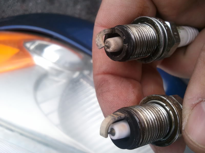

i think my head gasket is leaking, looking to replace
i got the milkyish oil, one spark plug looks shity and ill post a pic soon.

So here is an update with some pictures. just a week ago i did not know anything about hondas. zero ive been purley jeep strait 6's. mustang 5.0's and GM 3800's basically my whole life. this is fun and new for a change lol
anyway, here is a picture, this is from the cyl left center. this is what originally made me think head gasket

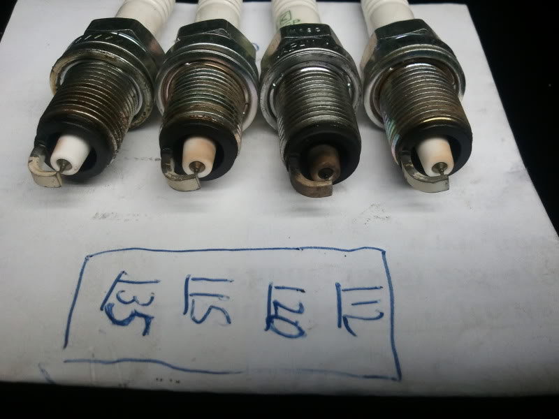

so i changed plugs and after about 100 miles i took them out today and this is what they look like
here is a picture with my compresson numbers. I forgot to hold the throttle wide open so i think that has something to do with the low numbers, but regardless they are weak.
the dark spark plug is the one that is in the hole the bad plug came out of in the first pic

The compression test is pretty low but not bad for a 200k mileage motor. The numbers should be at least I think 15 psi from each other. So the one on the left is alittle far off from the others. There are tons of things that you can tell in a compression test, it can tell if the head gasket is leaking, if your rings are bad, or something with the valves. Now mainly its usually the head gasket but can be burnt valves or piston rings have worn the cylinders or burnt rings.
Now that plug looks awful from the amount of miles it has on it. That cylinder is running rich as hell which is the cause of wrong fuel air mixture.
Now you said you have milky oil so is it overheating. To me it seems like a headgasket but it can use a slight rebuild.

the new plugs in the picture were in there for a day and that one has some serious soot on it. how hard is it to swap injectors? i might do this and see if the soot switches with injector swap. i will also recheck compression with WOT and hot motor

the dark sooted plug pictured above is now a light brown and they all look very similar

I only ran that for a day and then i drained the oil and poured half a quart of new oil through till it was draining cleaner. I proceeded to do the other 2.5 quarts in it with 1 pint of marvel mystery oil. its about half way up the add/full marks and has not changed over the last 500 miles i have driven since the oil change. next week ill change the oil again and this time do a filter and maybe restore but im holding off on doing that oil change until i figure out if im going to go through with the headgasket or not
That one plug has now mysteriously changed color again.
that dark plug is the top plug in this picture, i took this today. as you can see its not dark anymore and it looks like its getting covered in a cream colored hard layer especially when you compare it to the plug underneath it that has the same few hundred miles on it

I am going to say that its not the headgasket then. Based upon what you said the motor seems to be worn.
Your saying powerband is the same from 3k- basically red line, is a good indication of worn rings.
I would really like to know why your oil is milky white though. If your not overheating and your heat works fine chances are its not the headgasket.

I did mention in my first post that the oil was milky looking on the stick. I did just wash the engine bay and after thinking about it perhaps some dripped down the tube. after that day and everyday after there is no milkshake anywhere. when i drained that oil out it was black but no milkshake at all just oil.
I went ahead and did a valve adjustment yesterday and besides being way to much slack especially in the exhaust side, everything looked great including cam, rollers, timing belt and oil. very surprised actually lol.
One thing i did was check the torque on the head bolts, stock is 51 lbs i went ahead and set my wrench 5 lbs higher (56) and from center out ran along the bolts and two bolts got about an 1/8 turn out of them before reaching the pressure. those were the bolts around the cyl 3 that has the plug problems. idk if that did anything, but the valve adjustment made my car super quiet which is fantastic
im glad i did all this testing, i would have been wasting my time and money doing a full headgasket/rebuild on this motor. Im just going to change the oil again, change the trans oil and i think it will be fine going on my 1500 mile trip in two weeks... fingers crossed i can deal with worn rings the motor doesnt smoke it just doesnt make much power, im still getting about 9-9.5 0-60 times which i think is only a few tenths off what it did new
