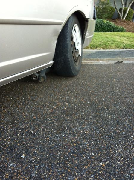

I got in a wreck, lady ran a red light, nailed my back driverside tire and this is what it looks like now.
I know it's hard to tell from the pictures, but what do I have here?

It looks like the bolts connecting the trailing arm to the subframe just sheared, relatively minor repair.

^^ He's talking about #27. Replace those but, chances are that there are other parts bent if the the front of the arm is on the ground. If replacing the bolts doesn't work try replacing #'s 18, 9, and possibly 4. If that still doesn't fix it try replacing the entire arm- #15. If that doesn't fix it then replace #3. And if that still doesn't fix it I would look at the mounts where everything attaches to the body.
*Make sure to inspect everything really good and if anything seems even slightly off replace it.

prolly gonna be mostly suspension related. having a rear hit is much better than in the front. i would take it to a shop and get some estimates.
