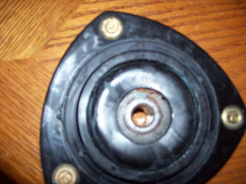

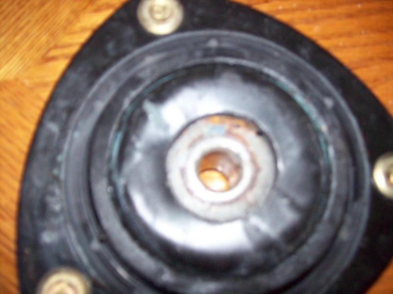

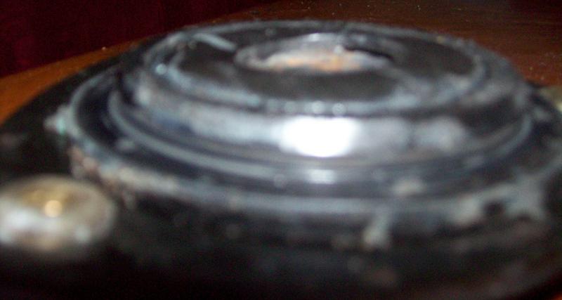

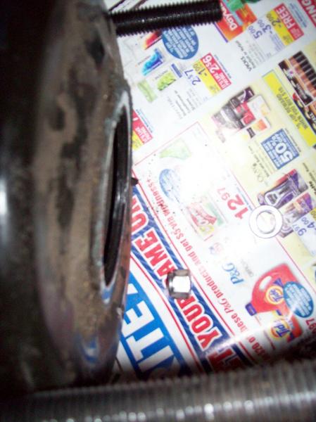

So Im working on the suspension today. I have opened the sturt and compressed the spring and opened the mount. The mount looks bent and there is nothing wrong with the sturt bearings.

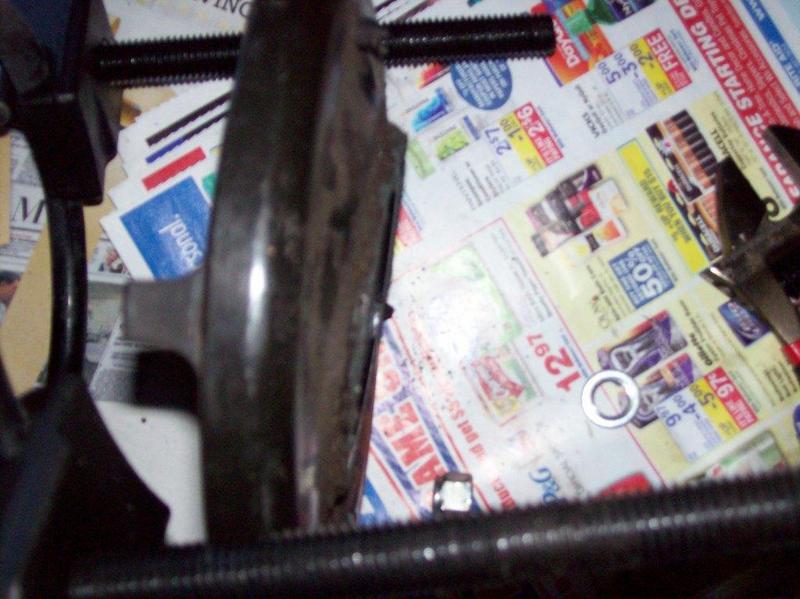

Plus the spring seat should be like that ?
Check the pics please. I have everything open right now and I might have to run to the dealer to get the mounts if they have them
Thanks

Your camera wouldn't happen to have a macro function, would it? Take close-up pics using that mode. It's kinda hard to tell what I'm looking at otherwise

I put everything back together and I'm going to order the mounts and the spring seats.

Notice that the strut bearing are not crack or anything? They are plastic but nothing wrong with them. The bent mount and spring seat it what causing the clucking noise in my case

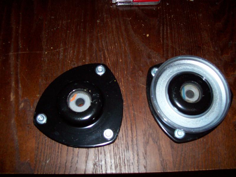

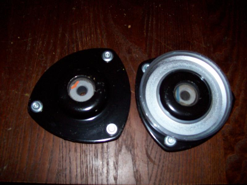

I got the new parts and the Strut mounts looks little wierd
There is a metal peace that doesnt belong there in the top of the mount?
Please check the picture and let me know if i should return it or try to pry out that metal peace
Thanks

That Metal Ring on top of the mount seems to be pressed in. Is this 02+ Part ? Anybody know why this mount look like that ?

Don't pry off the metal piece, the original strut mounts were weak and that is the new design. Those are exactly the same as my mounts and they work just fine.

But they dont fit the plastic bearings and the spring seats right ?
I mean what else comes with it ? or what else do i have to buy with to complete the set ? Do you have 01 civic or 02 ?
Plus why they sent me old version and new version ? Weird

MindBomber The plastic bearings does not fit they only change is this metal ring which make all the old top part dont fit ... Is there new bearings and spring seats ?

I drive a 2002, the bearings are contained within the part you have.

I deleted the part numbers to make it easier to read, now it just shows the reference numbers on the diagram. The part you have should be part of an assembly of several parts 11, 9, 7 if memory serves.

My civic is 01 EX part number for sturt mount is 51925-S5A-024
The part number for 02 (Yours) is 51925-S5A-751
Not the same part number and price
Plus the metal ring does not move and it doesn't have bearings. Maybe the bearings from 02 will fit in the metal ring because the 02 bearing are larger in size

Have you verified that you were sent the correct part?
There are a couple different designs of strut mounts in 7th gens.
The metal ring is not supposed to move, the bearing fits within the metal disk.

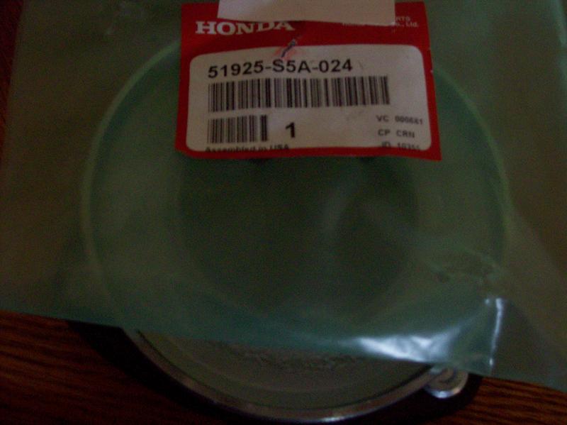

MindBomber
Check the pictures below with the part numbers I believe that they put an 02 mount which is part number 51925-S5A-751 in the 01 label 51925-S5A-024
I dont know what to do at this point ? Now that I have new plastic bearings and spring seat that belong to the 01 old setup and one old design mount and one maybe new redesigned mount.
I sent Majestic an email with pictures but they havent answered me yet I even called them and they said that they want to check the email first

I went to a Honda dealer and found part number 51925-S5A-024 so I bought it ! The part that Majestic sent me was for 02 and it was miss labeled and they will not guarantee that if I ordered another it will be the same...
Now I installed everything into my car and i dont hear the clunking noise anymore but I do hear some noises but at this point I don't care.. I still need a camber kit
Thanks MindBomber for everything and i hope this thread will help somebody in the future

I noticed that the picture (2nd one from the right) the "007 SEAT, FR. SPRING (UPPER) " looks bent..is it supposed to be bent?
