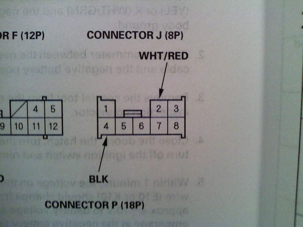

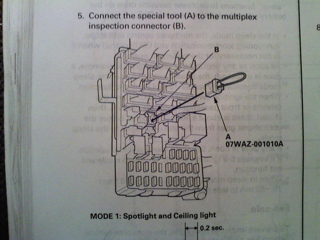

Check the MCU:
1. Turn ignition ON (II) then turn dome light to the center position and close all doors.
2. The pic shows a "special" tool which is only a fancy jumper wire. Hook a jumper wire up to the MCU as shown:
3. Once it's connected after 5 seconds the spotlight and ceiling light will should come on for 2 seconds then go out and come back on for 0.2 seconds to show it's in Mode 1.
4. If it doesn't come on then check continuity between terminal 4 (black) of connector J (ref- 21 in the pic) and body ground.
Is there continuity?
YES- replace MCU
NO- repair open in wire. if wire is good, repair G301. (I'll tell ya G301 if you need)

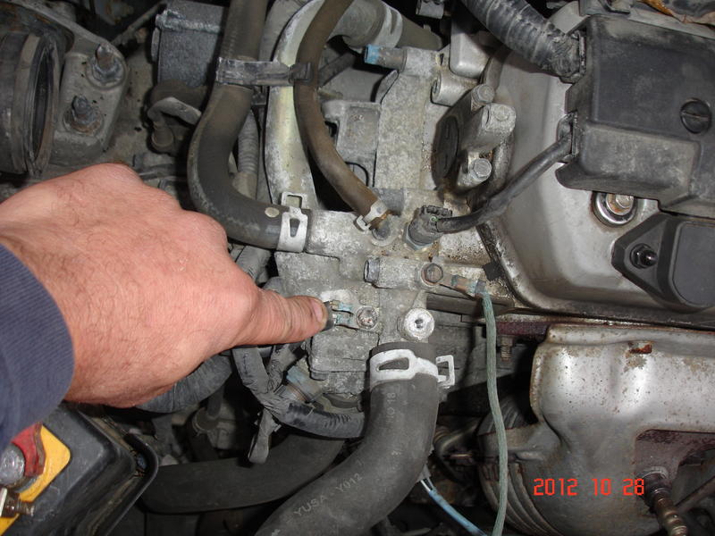

Hello,
I have been chasing the same exact problem for a friend. Charge indicator on all the time, engine idle surging and momentarily dropping out the same time that the relay behind the glove box clicks. This happens every 20-30 seconds and after a few minutes the relay stops clicking, check engine light comes on, tachometer stops working idle is elevated and steady and severe lack of power. If you are monitoring it with a scanner it will lose communication when the check engine light illuminates. I found an answer for a portion of the problem. The ground at the top of the cylinder head above the upper radiator hose connection was faulty. I checked continuity from this connection to the neg cable and had .3 ohms resistance. Looked ok to me. I decided to try to manipulate this ground while the engine was running and problem was occurring. As I tightened the ground more it made no difference. Then I tried to loosen the bolt to move the ground lugs to the position they were in before. Accidentily loosened it too much and stalled the engine. I retightened the connection and the car has been running fine for quite a while tonight. The charge indicator is still on but the alternator is charging. Will get into that next if he wants to chase it. Will replace the ends tomorrow and drive it more. If I can I am going to post a pic of the ground lugs. Hope this helps someone out there.
Lee

Old Oct 28, 2012
Re: 2001 Civic LX with lots of problems
i replaced the factory grounds a while back and also redid that ecu ground you are pointing to with a ring terminal. as a temp fix, you can get sand paper and clean both the ground strap and the block surface of corrosion.
