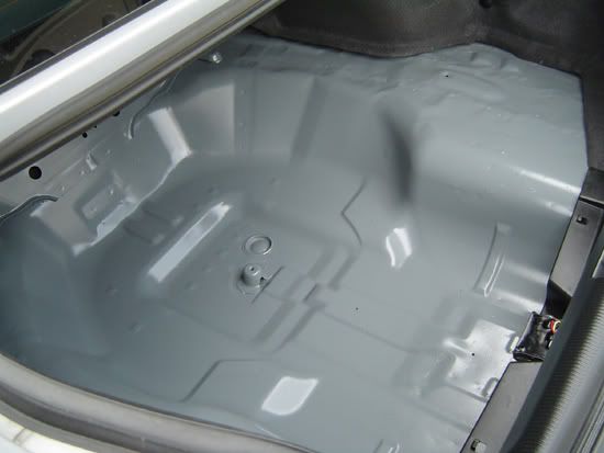

okay i got most of the tar and crap off, im gonna try and sand down all the rough areas and primer+paint it hoping for the best. im using that speckle paint black with grey dots lol. the problem is there is alot of body work crap like bondo and stuff on one side so its gonna look uneven in some spots. will post some pics later of the process.
Old May 10, 2008
Re: leaky trunk
got it all primed and painted with rust tough "battleship grey" lol. it looks nice but im not too happy with the body work on the right from the accident. i may just end up getting a new cardboard piece and carpet mat from honda cause it looks kinda bare. but im glad i got it painted at least so it doesnt rust.

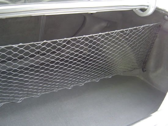

Re: leaky trunk
lol no i saw that moonroof drain plug but it was secure with a rubber piece. mine was an actual hole in the metal frame that got poked out of something. it lead directly to the wheel well so everytime i drove in the rain, dirty water would splash in.
i got the oem cardboard and carpet pieces on order, and also found a really nice cargo net. will post a few pics later once installed.
Old May 22, 2008
Re: leaky trunk
and all put together, with aftermarket cargo net
