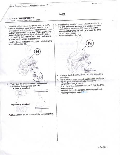

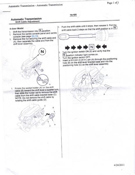

Heres how to do it..and the reason it happened is more then likely you slammed your car in park while it was moving.
Its actually a built in safety so you dont destroy the transmission doing that..
ID:	84564   Click image for larger version
