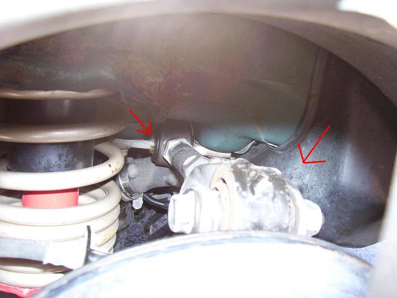

my suggestion is to check to see if the upper control arm is bent at all, if not, something is out of place, if its bent get a camber kit, it will replace the upper control arm, and possibly solve the problem, heres a pic to help
