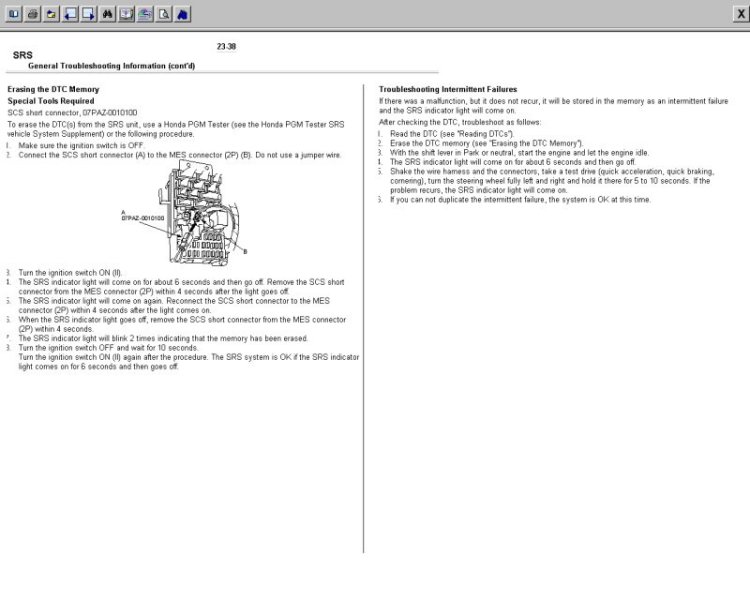

here is the test procedure, i recommend using the honda specified tool. BUT i know it can be done with a jumper wire

if you need a larger image let me know and ill e-mail them to ya

thanks bro!!! I just did what you said with the DIY I found searching to reset the srs...it worked!!! And, I used a paperclip, had to do it a few times since I didn't have the honda little accessory, the srs light is off, I just hope there was nothing really wrong with my airbag system - the diy says if you problem is fixed then the light will reset, so I am thinkin my srs airbag system should work fine if I get in a bad wreck, I just don't know why it came on to begin with!!! All I did is replace my dead battery a few days ago. Thanks tfnaaf!!!! I apreciate it bro and thanks for DIY whoever did it!!!!!!! 7th gen has saved me countless $$$$ and keeps me from the shady honda dealer......
