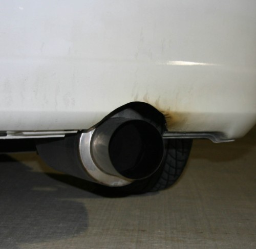

i have had my tsudo n1 catback for a while now and ive been just sanding and painting were the bumper gets burned does anyone have a solution to this or has the same problem

yea i have the same problems but my exhuast is the Fireball, one thing is our car is white and tend to show more and the other is too close to the bumber what i did was i extend where ur muffler hanger the rubber mounts i have gotten longer one so it doesnt burn as much no more, what i used to do is clean after every ride but really i havent found nothing that would stop this unless somebody out there have the idea to.

I have an hks hi-power rear section and my rear lip is burning up like that too, plus the paint is bubbling up . The muffler is not touching the rear lip or anything like that, jus the smoke coming from it. I saw a pic of a person who put High Temperature tape where it was burning to prevent the burn marks. Now you just have a piece of tape there instead.

Go buy Thermal Tape.

oky, i found some Spoon Sports heat tape, is that good for exhaust?
