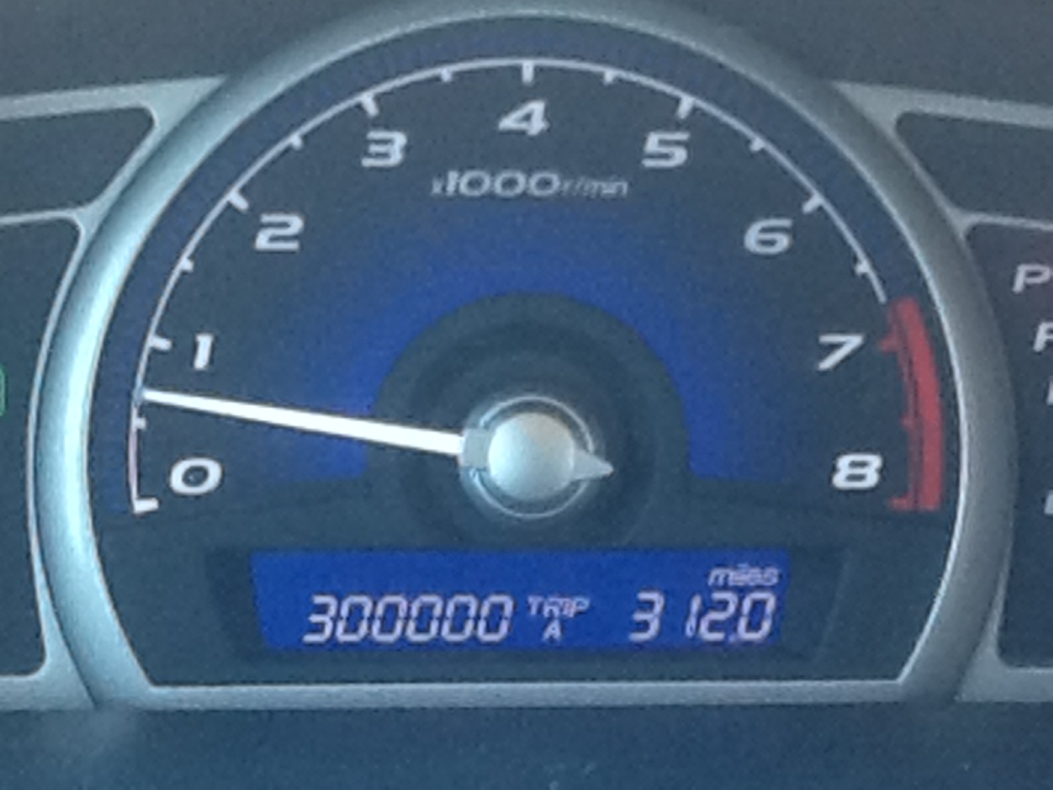

They also want receipts showing tire purchases. I didn't have enough room in my glove box for all those! Imagine how many tires I've replaced by now, even with the new control arms installed @ 80K miles.
