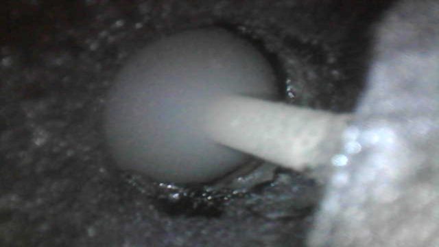

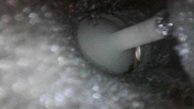

Yeah German manufactures have been battling it for a while now. The Japanese manufactures were slower to adopt DI it seems and they have less issues with it. Well Subaru has problems with it but Boxer engines have their own issues all together. I can see the German companies basically saying that is the way it is just walnut blast them every 60k-100k miles and move on. It's part of the engine maintenance to keep it at optimal performance. Small shops will do the service for $300-$500.
These are my valves from my GTI with 50k miles on it. These were considered good for that mileage. Car runs and idles smooth still.
