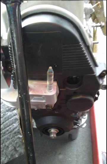

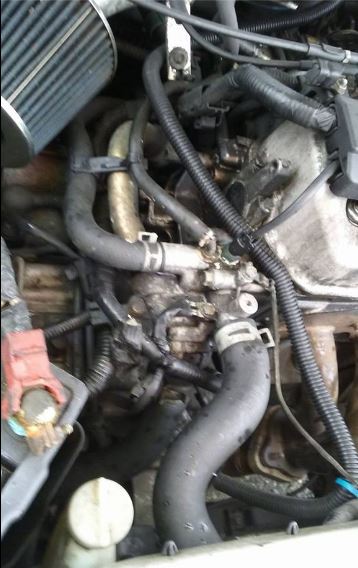

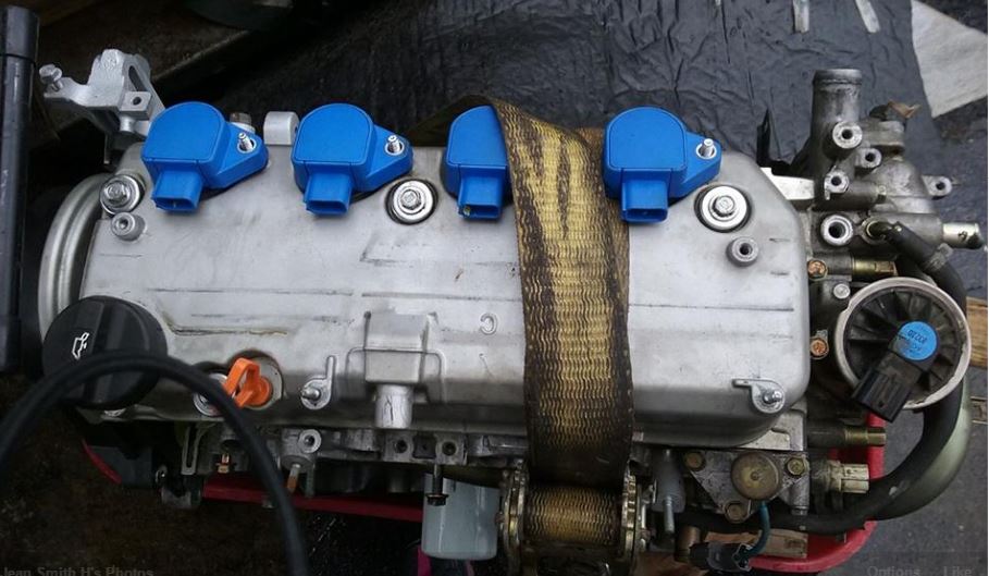

I know my LX engine doesn’t have the vtec solenoid plug.
Question: I know it doesn’t have the vtec solenoid plug in my LX Engine. it’s okay that I don’t connect Vtec Solenoid and the car will still run okay?
My LX, non-vtec, the motor didn’t have an EGR valve but the vtec one had an EGR built into the thermostat housing.
Question: my non-vtec motor didn’t have an EGR valve but the vtec one had an EGR built into the thermostat housing. It's okay that I don't connect EGR valve to my car will still run okay?
I have talked with the Mechanic and he said, your LX engine don't have Vtec Solenoid & EGR Plug-in. I do not give Labor Warranty after I swap EX Vtec Engine to your LX car and your vehicle is not running and I do not give the guarantee that your vehicle will run.
So, my biggest concern is I have to pay the mechanic either Vehicle is running or not after he swaps the engine. Not knowing what actually caused the problem.
