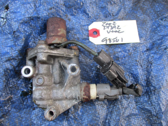

Originally Posted by Swebb
Did your jdm engine have a the pressure sensor for vtec?
It does not, it has a bolt in the hole the pressure sensor would normally screw into. You could take that bolt out and screw a pressure switch in if you want to though, the hole is threaded for it. Then you would need to run a wire from the pressure switch to the appropriate pin on the ECU and it should be happy.
ahh that makes sense on my current problem then.
o and the hole you are referring to is on the vtec solenoid?
i gave up on that jdm ecu. Put the us ex ecu back in but still can’t get over 4000 rpm and get a vtec code.
I have a jdm harness but I think I saw the wire in the main harness for the oil pressure sensor but I can’t recall if I saw a plug in the engine bay.
you think that would resolve my issue?
It should. The US ECU just wants to see a signal from the pressure switch. If it doesn't see a signal, it goes into limp mode and does what yours is doing.
Yes it is. There is a 12MM bolt in the hole where the pressure switch would normally go to plug it off. The pressure switch is that rusty thing with the grey plug sticking out the side of the solenoid by the bottom of it. Does that make sense?
yup makes perfect sense.
just ordered the vvt oil pressure sensor and a pigtail In case my harness doesn’t have the plug. Going to see if that fixes my issue.

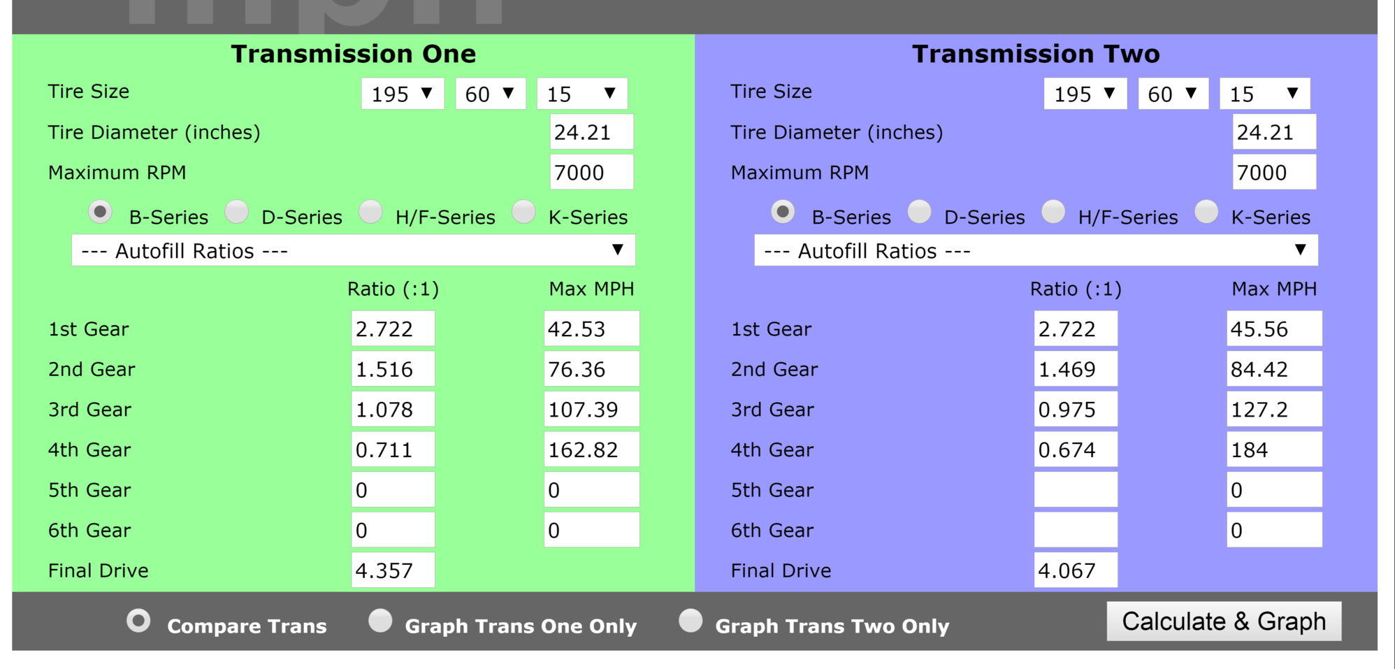

Originally Posted by Andym
I got now a jdm transmission in a 05 lx manufacturer in Canada I believe and I get engine light on and rpm are higher than normal at high speed, 70mph about 3050rpm or so and 80mph like 3500rpm. I feel really bad about this as my biggest concern is fuel economy and now is wasting more I believe. I feel frustrated with this rpm thing I just want it to go lower than it normally was before
Perfectly normal, the JDM transmission is just geared differently. The engine light is just on because the US ECU sees the higher cruising RPM as a problem since it's not what it expects.
As for lower MPG, I had the same concern but I didn't notice any drop with my setup, probably because I live in a hilly area and it climbs the hills better with this gearing. I still can get up to 38 MPG highway, about the same as the US trans. The EX 5 speed is geared for around 3500 RPM at 70 and 4000 RPM at 80 IIRC and still gets good MPG.
I actually prefer this gearing now that I am used to it. It has better acceleration when flooring it both off the line and when moving (important to me), it has more power and climbs hills better when cruising, the exhaust drone is more tolerable (a rumble instead of a deep roar), the trans will run cooler in traffic since the lower gearing won't work the torque converter as hard, and my MPG hasn't dropped. What's the downside?
Here are the ratios. Green is is JDM SLXA and blue is LX BMXA
Wow, glad to know that nice description with graphs. I just did notice faster acceleration which might be better for city driving I guess, don't know about highway since higher rpm if they will consume more or not, on highway I normally drive 70mph so wonder now. The mechanic who got the transmission installed supposedly fill it and all and showed me but it was shifting terrible and second day when I look the stick didn't mark any fluid, I had to add 1 quart and a half extra and now 2 , 3 gear shift so smooth barely noticed, 4th gear is like a little rough still. I think the mechanic put some autozone cheap trans fluid in it , I thought he was going to add OEM fluid but no, I did buy idemitsu z1 quart at auto part
