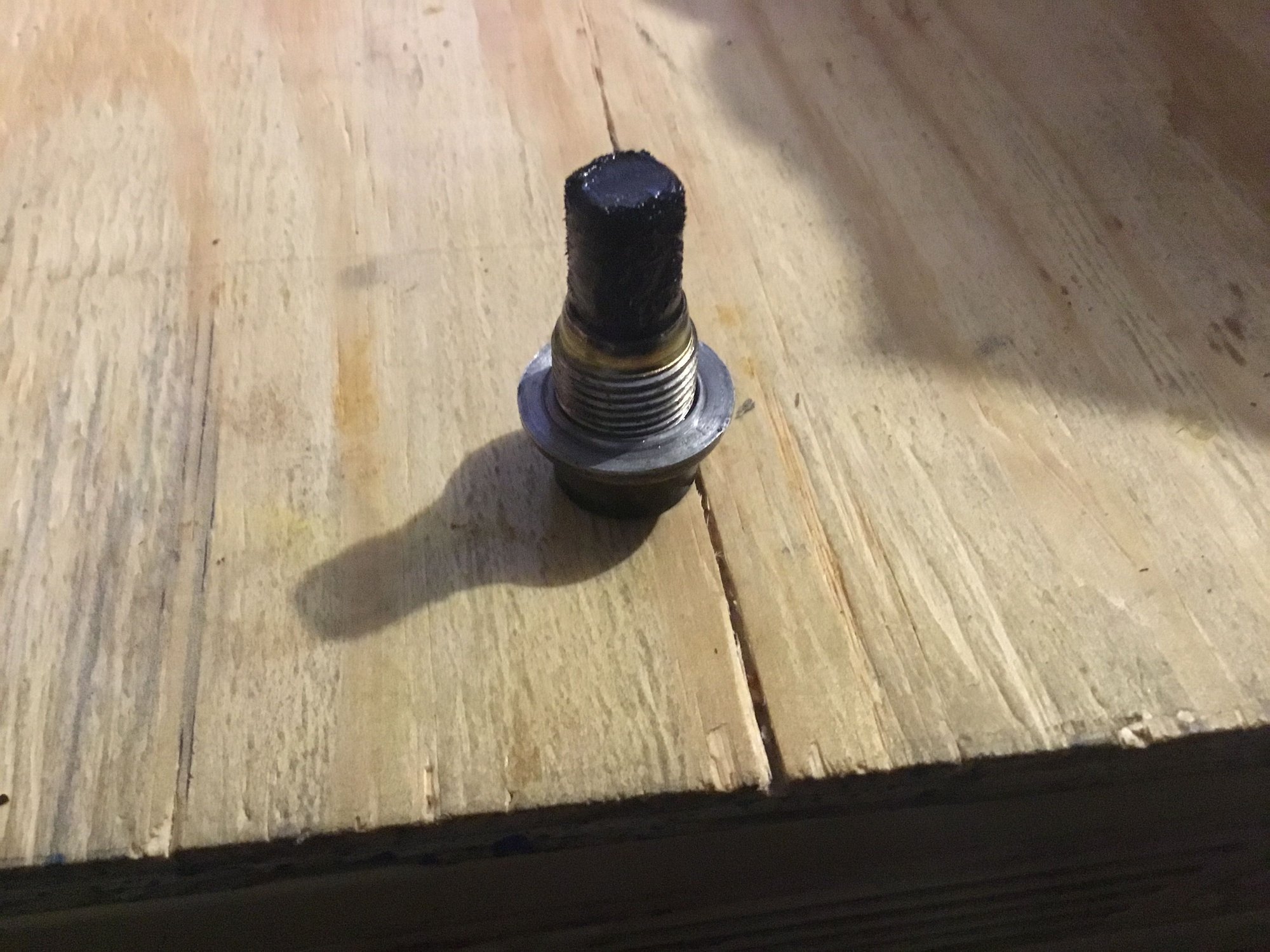

Thank you for your help, I plan to check the magnet on the drain plug for excessive metal particles to see how much damage was done, if any. I presume that if damage was done there would be more metal particles on the drain plug than usual?

Well I checked the magnetic drain plug for particles a few days ago when I installed a transmission temp gauge, and I didn't see anything that I consider terrible for 7K miles of driving. Here's a picture of it. Thoughts?
