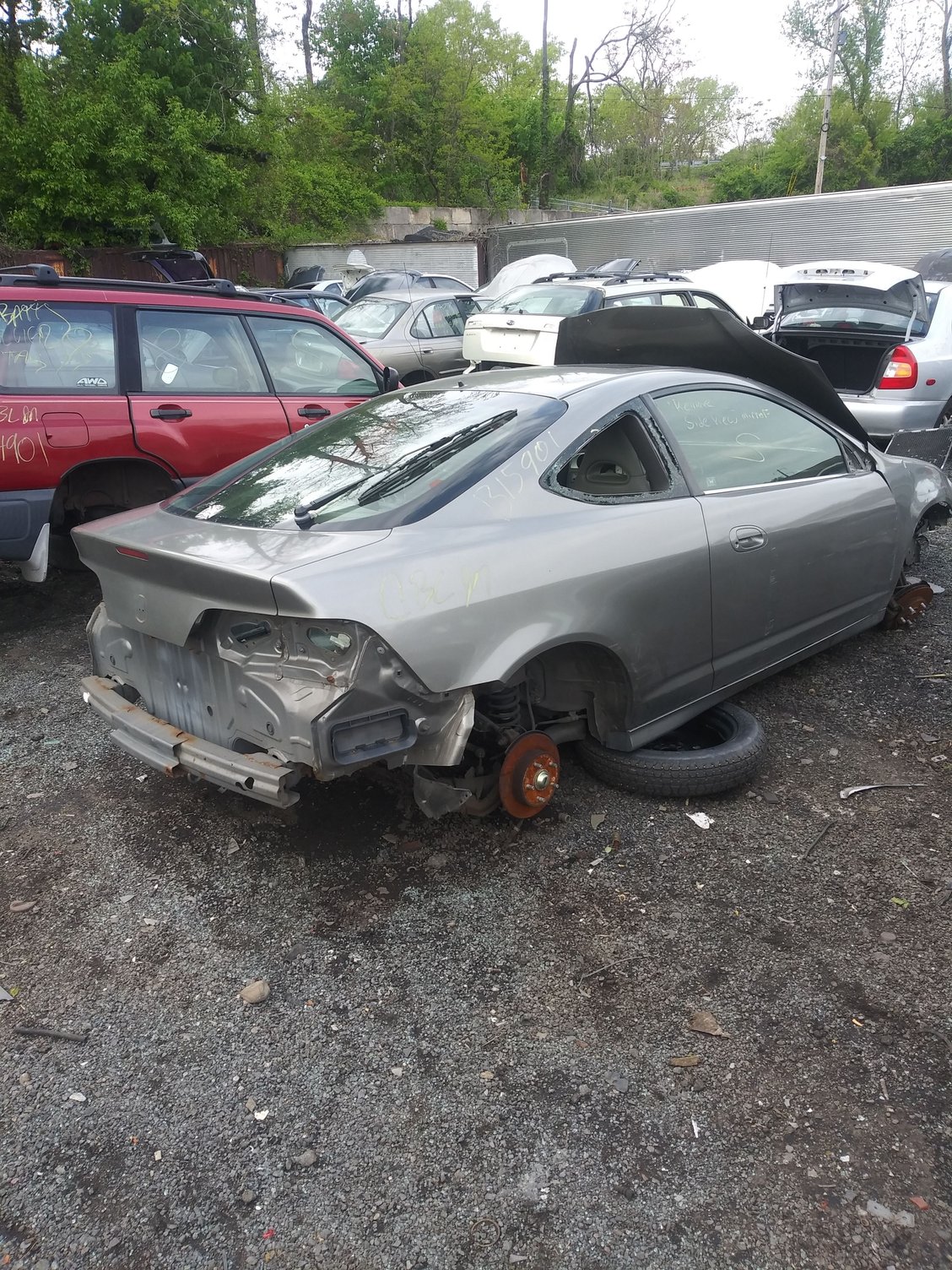

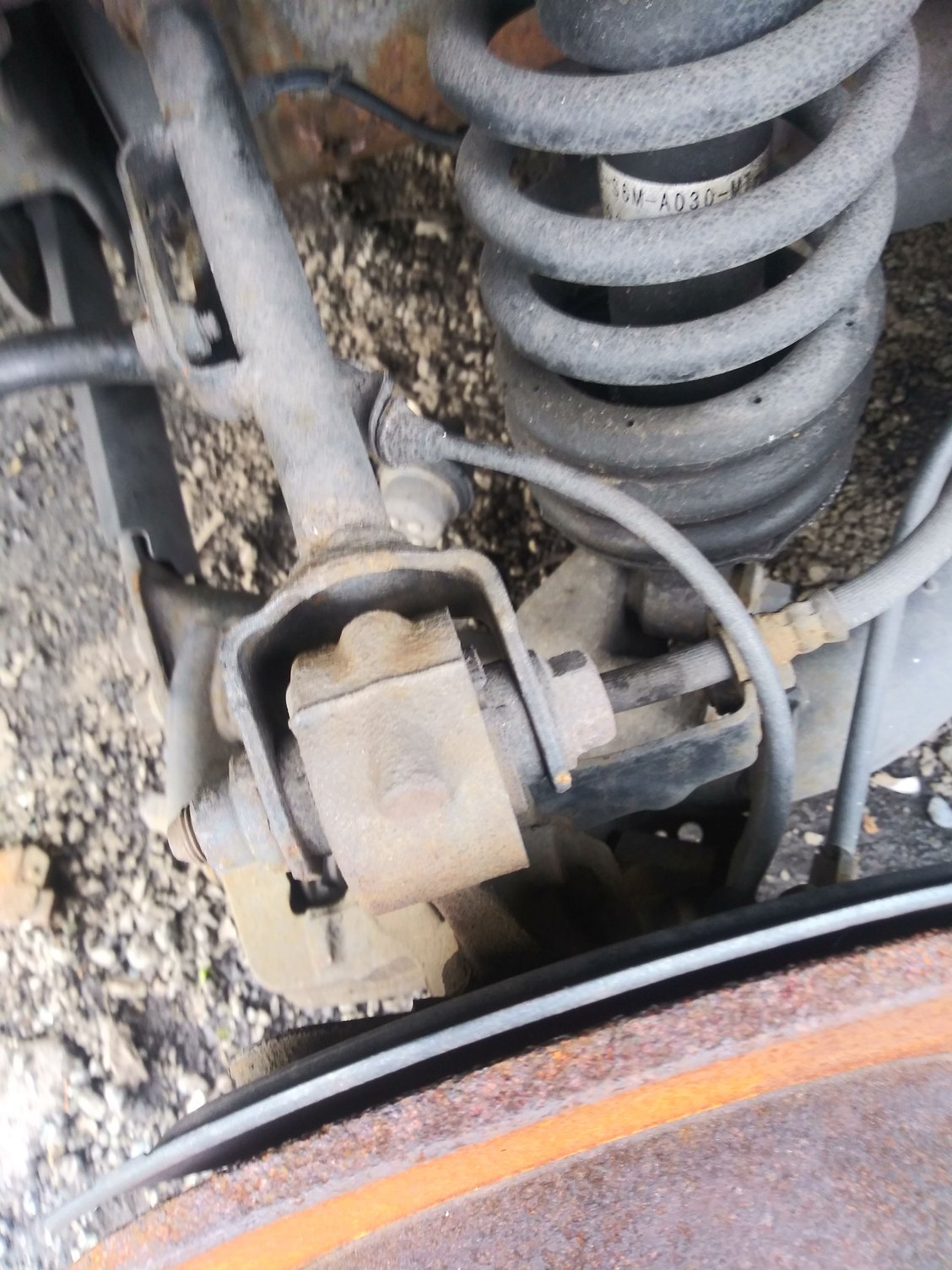

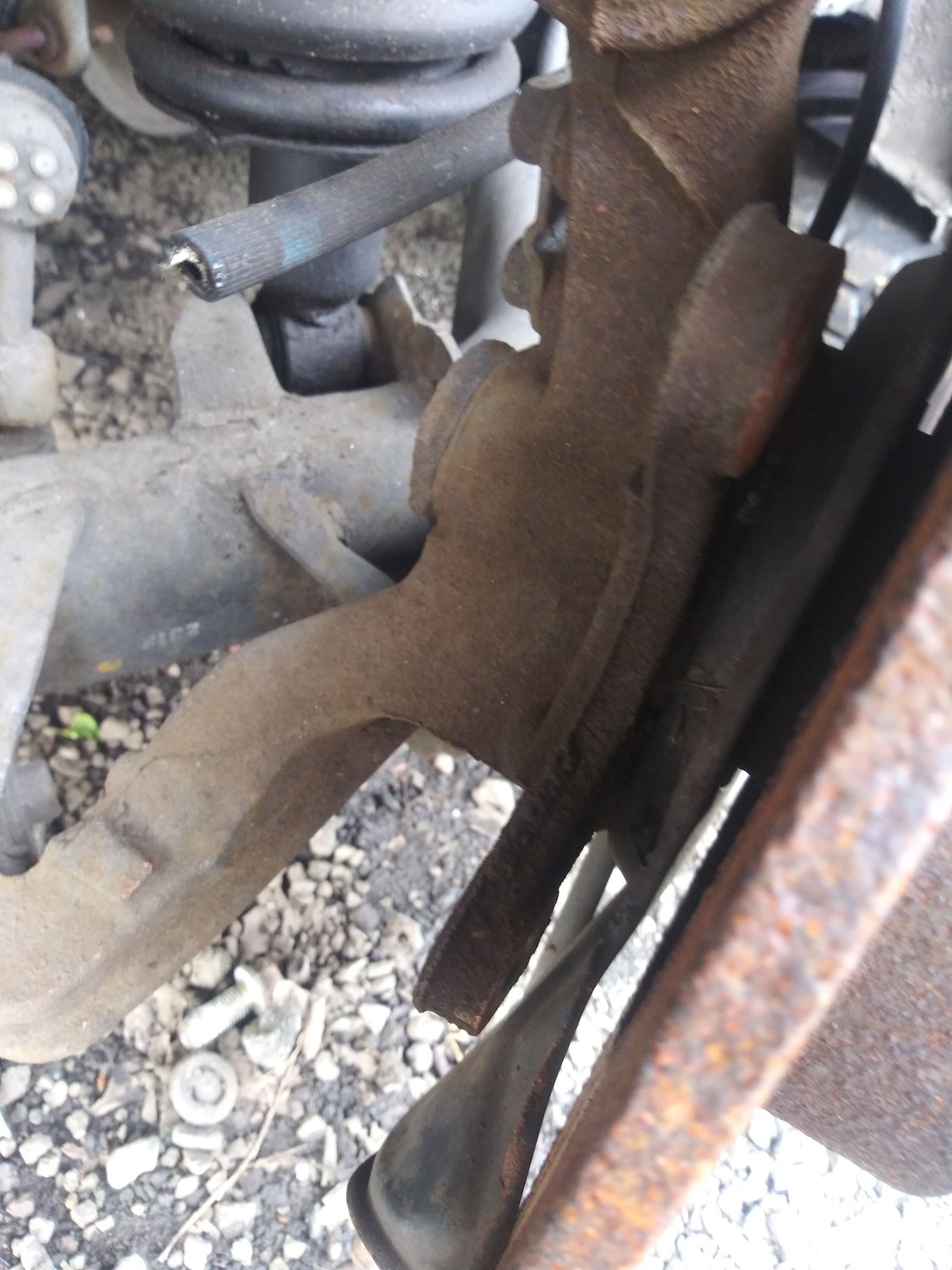

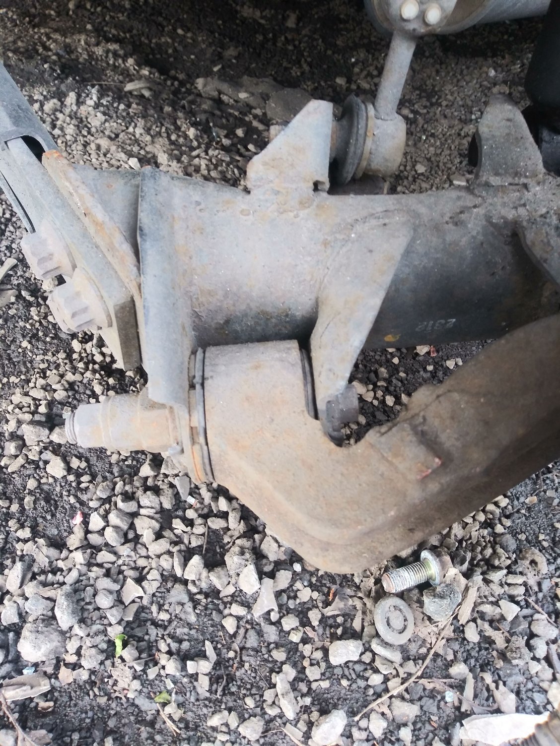

I actually went and visited a few more junkyards. I did come across an 02 rsx. Can i use the spindles for the rear disc conversion from these?

You can, but then you will have 5 bolt in the rear, and I don't know if the 5 bolt hubs for the front will work with the d17 axles

You can use the RSX rear knuckle/hubs if you want disc brakes, but you will also be going to 5 lug. I've never heard of anyone saying you need larger wheels to do so. The Civic Si has the same size rear disc brakes and comes with 15" wheels. If you want rear disc brakes and 4 lug you have to find a '02-'03 Civic Si (USDM).
As for the fronts the RSX Type S has larger brake rotors which may require a larger wheel. However, these hubs will not accept the Civic's axles. Base model RSX would be a direct swap and give you 5 lug hubs.
