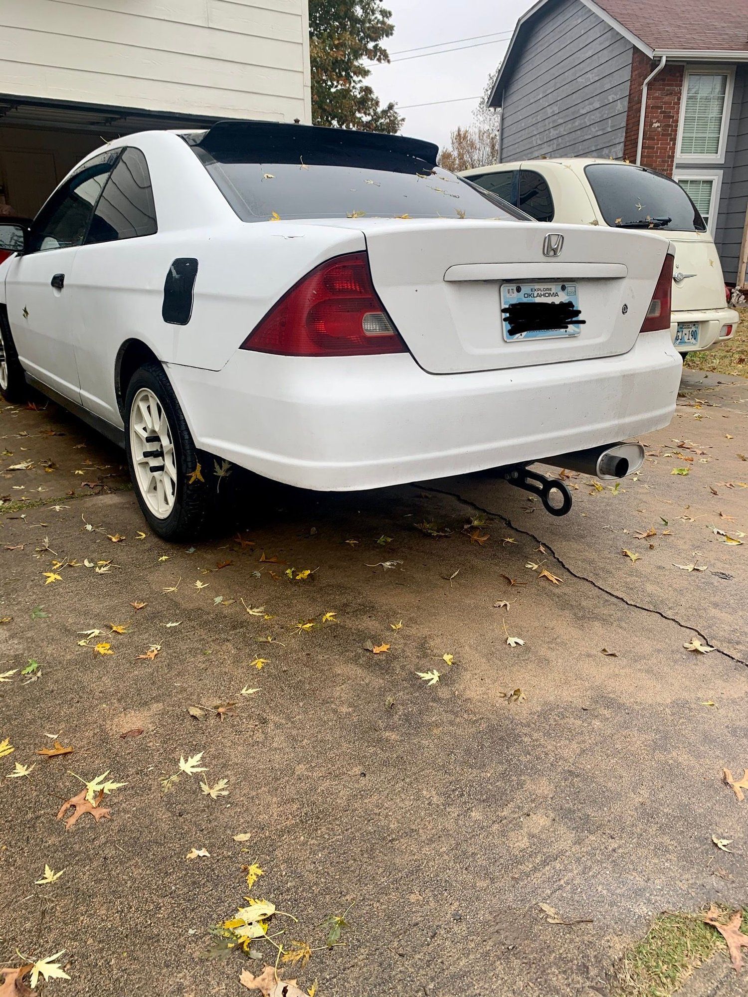

This is Oreo, a 2001 Honda Civic Lx this one I have had for 3 years boosted at 200,000 now at 295,678. Most of that coming from beating a delivery driver for 2 years. Has never really given me an issue except for the oil pan gaskets and burning oil before installing oil cooler( how to measure mpg on turbo civic before and after oil cooler. After: mpg of gas, before: Mpg of oil)

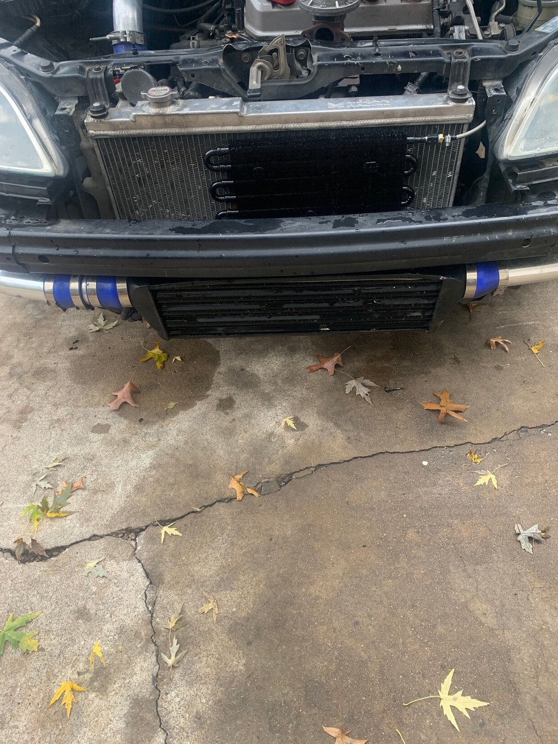

So first things first the biggest pain with this car is finding intercooling piping that will fit . The neck that connects to the manifold is part of the kit for this car, all the rest of the intercooling piping is from a 95 Acura integra kit that just happens to fit with a few modifications and to answer the question previously asked the ac will have to go it gets in the way of the piping theist is so little room and clearance in this car this 1/4 ratchet by titan is my new best friend

The inter cooler round is as such
Old Nov 7, 2019
  #49
Marcelo Souza's Avatar
Joined: Oct 2019
Posts: 69
Marcelo Souza is an unknown quantity at this point
Re: Ktuner and the D17
The inter cooler is from just speed it fits snug under the bumper if you trim the inside a little
