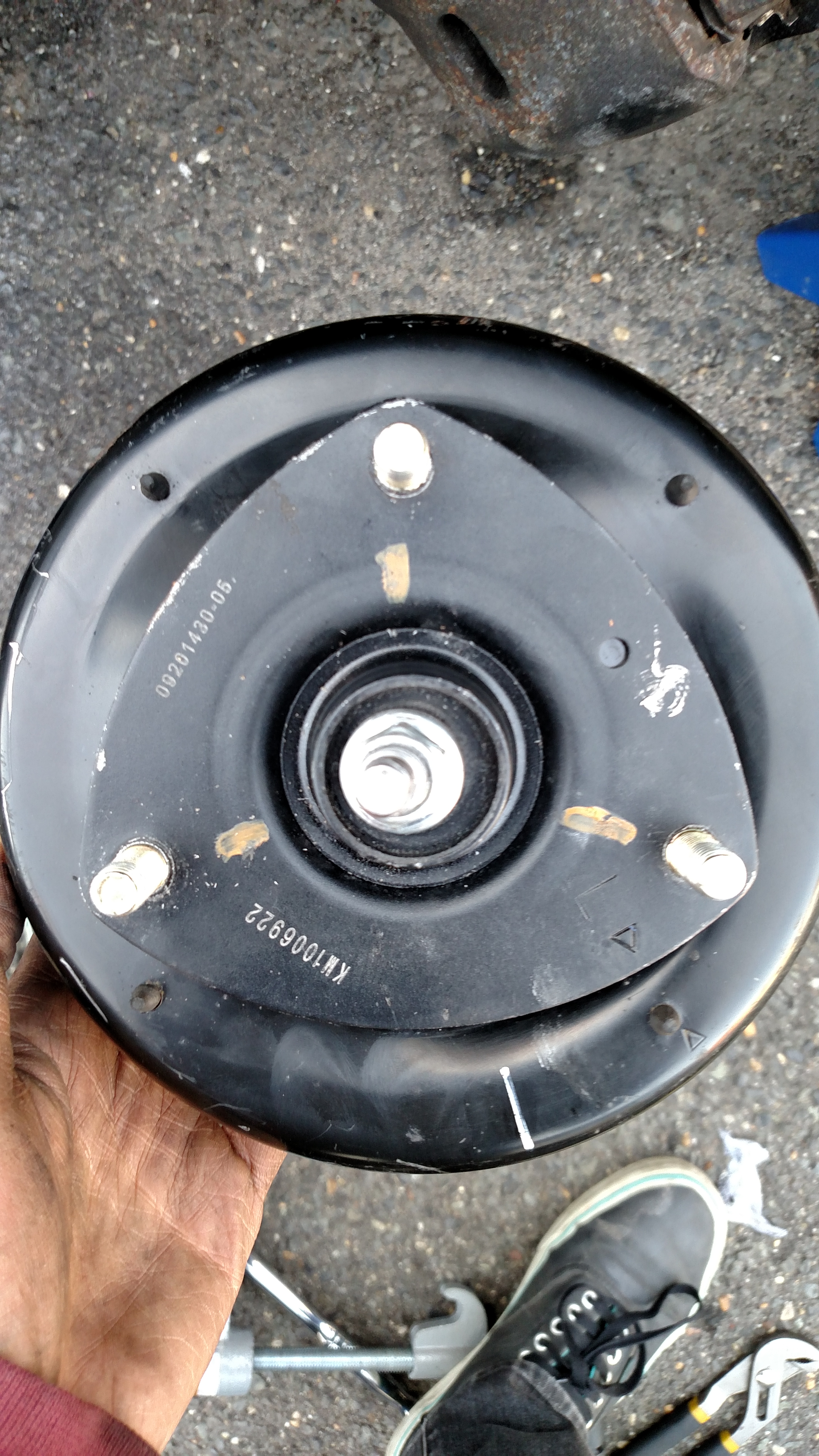

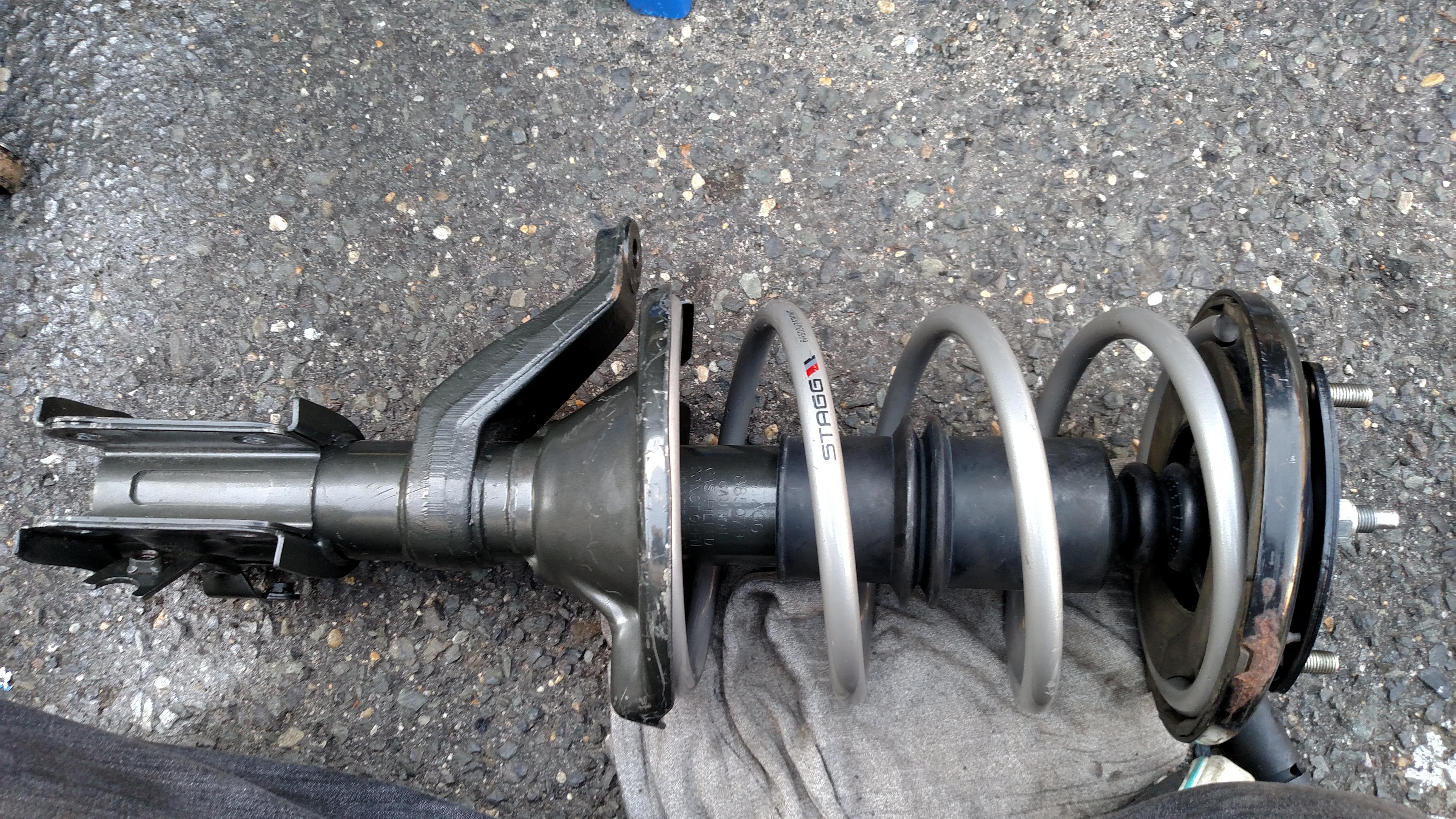

So I was putting the dust/bumper cover on these front struts and after aligning the two arrows I can't see to fit the strut back in there properly. You can see what I mean in the pictures. Also the top hat has a letter L does that mean that belongs to drivers side? And another question is the spring mounted properly or upside down since the letters of stagg are upside? Mainly I want to know why it doesn't fit back into the assembly maybe I lift the arm too much w the jack and now I have to put pressure back to bring it down?

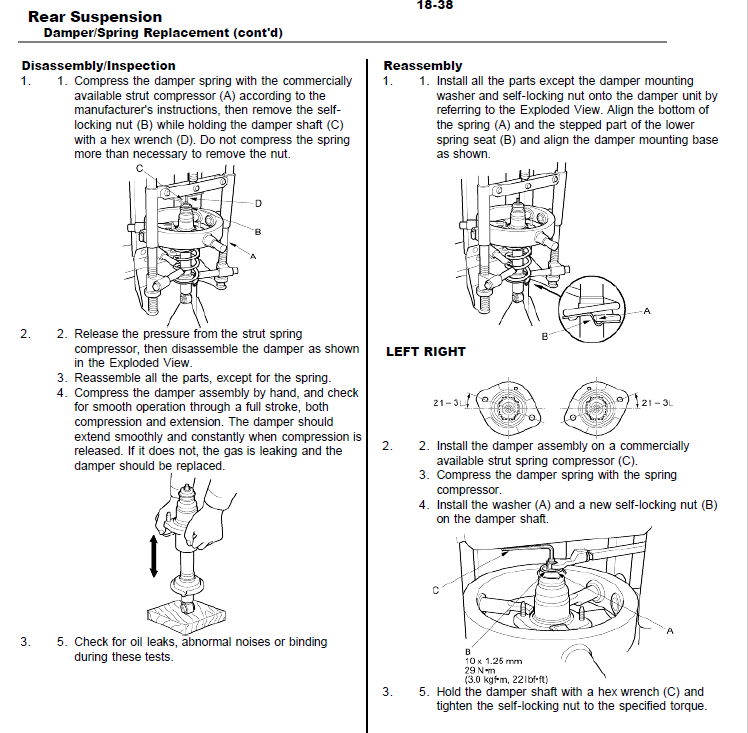

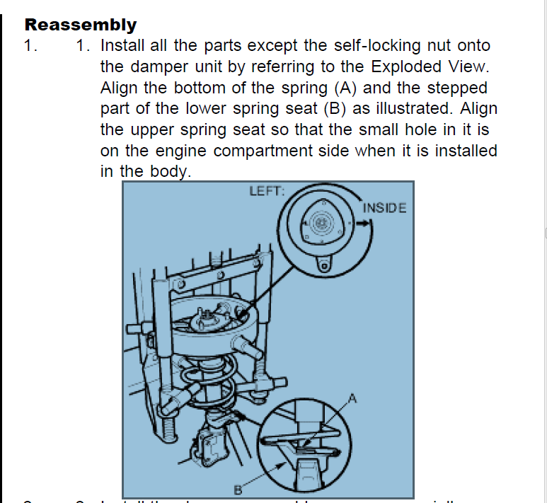

Here's a pic of the service manual explaining how to align the strut with the spring.
You can see that the arrow is facing out and it says that there should be a dot or hole facing towards the inside
Name:	spring install.png

Here is some pics with the rear spring/shock installation
ID:	89210   Click image for larger version

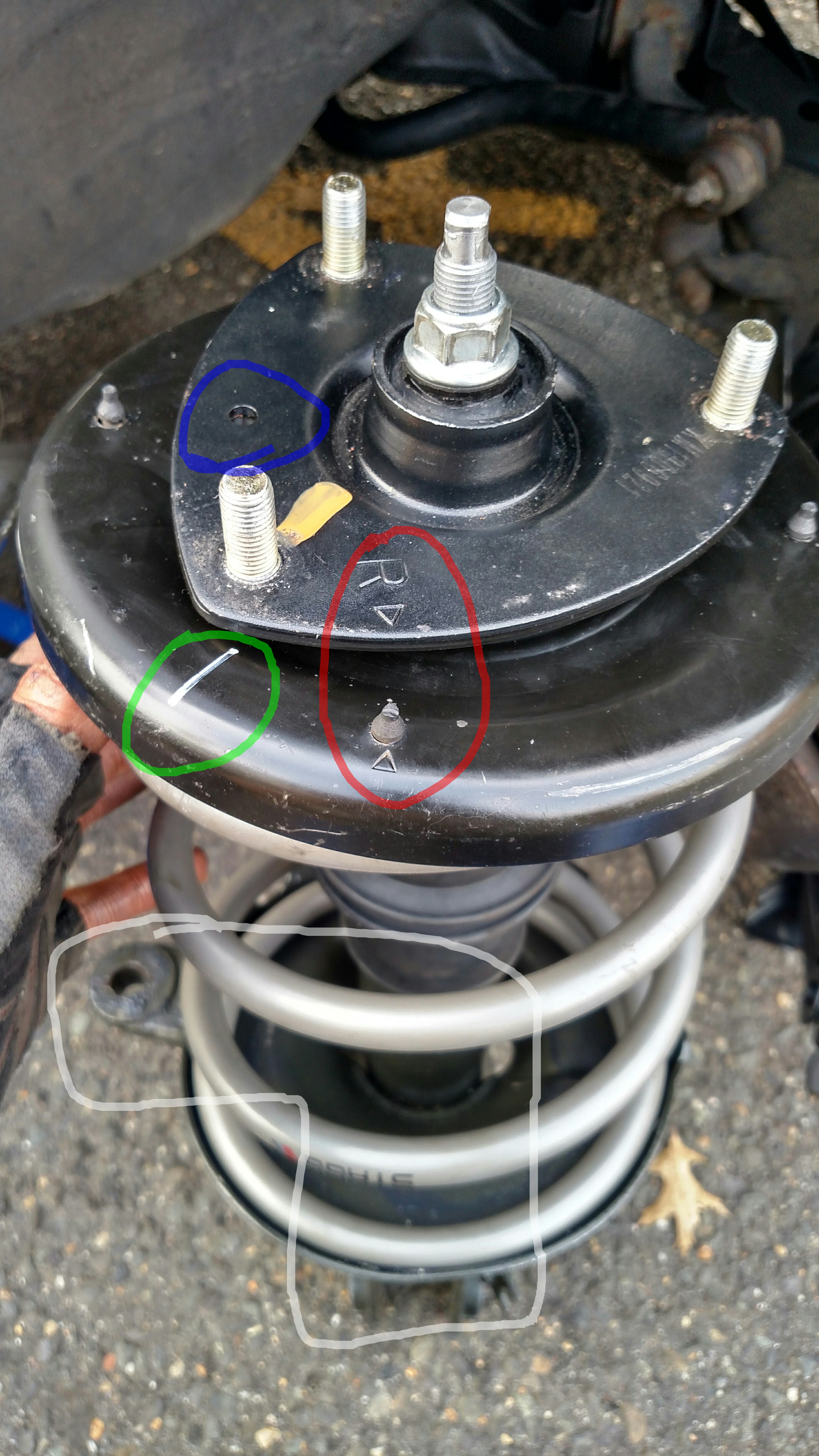

Oh man so yesterday I aligned the arrows and there a noise and today I pointed it one of the arrows to the outside in a diagonal way trying to follow the slant of the car and nothing, even more noise when turning the car on a test drive. The holes yea that's fine because the 3 bolts only fit into the car one way. The top hat has an arrow as well and the golden question would be what does that match to?

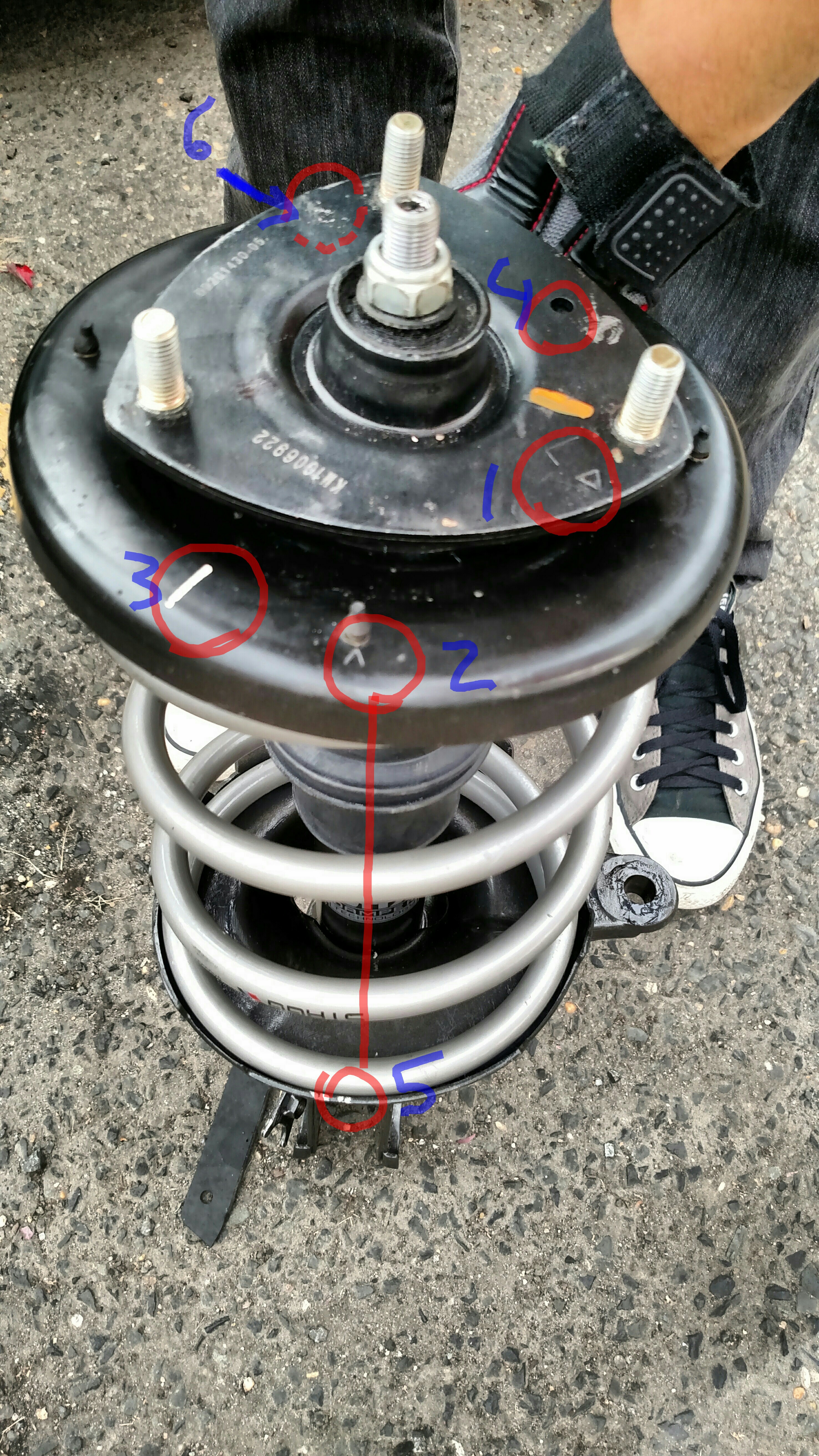

I guess to put it in lamens terms, what number will align with what number? Im thinking aligning the bottom perch hole (5) with the notch mark (6) that way the arrow (2) will point out. Another option will be to align the paint mark (3) with the perch hole (5) making the arrow (2) point in towards the engine.
I guess it's obvious to state that 4 and 1 cannot be moved since that's the way the bolts/flange goes into the car. Also the notch/mark (6) is exactly 180 degree away from arrow (2).
My best solution so far to try tomorrow will be to align 5 with 6 that will make 2 point out and 3 align with 4. Every number seems to be in use so this solution gives me a good indicative of being correct.
