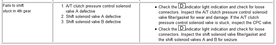

Could be material clogging the screens under those solenoids too.
