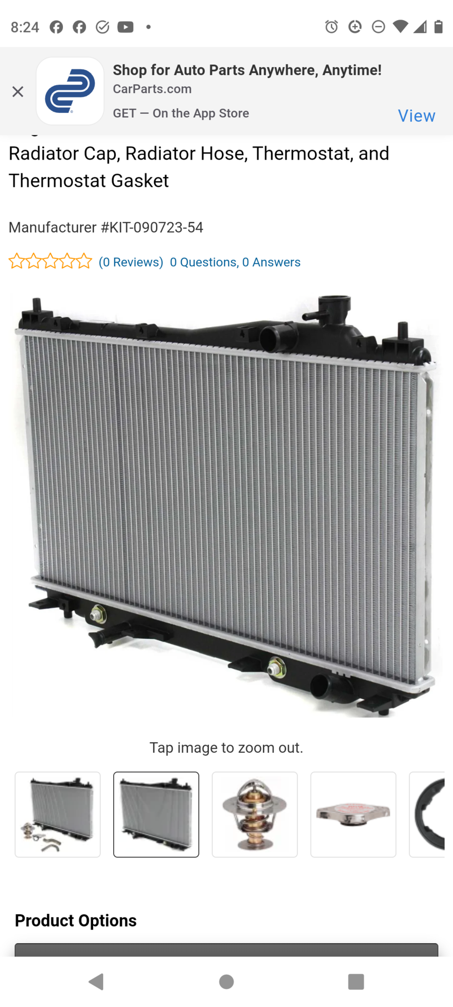

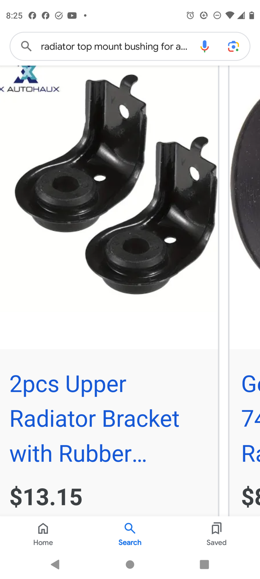

After looking around on the Internet I found these and the rubber bushings seem to be the suspect in this case.

A little movement in the radiator is normal. Those rubber bushings don't go bad.

I just went under the hood again and for sure, the studs on top of the radiator are moving around too much inside of the radiator mounting bracket bushing. Maybe the radiator that's in the car now is aftermarket and the studs on the top of the radiator are smaller than OEM. As for the overflow reservoir goes I siphoned some coolant out and could see, somehow even though the reservoir is beyond it's useful age, that the level is now correct.

Every car I've ever worked on has a radiator that will wiggle around. It's not an issue unless the rubber bushing is completely gone.

I just finished up putting the new bushings on but the radiator moves but not as much..and the original bushings didn't show a sign of wear. Lesson learned.. here's the battle scar left from stubborn bolts.
