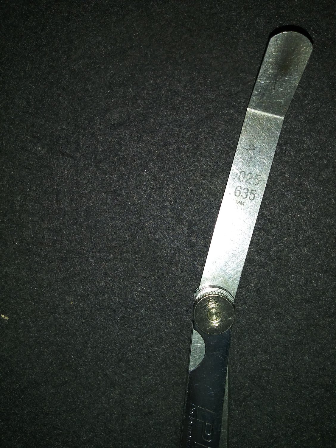

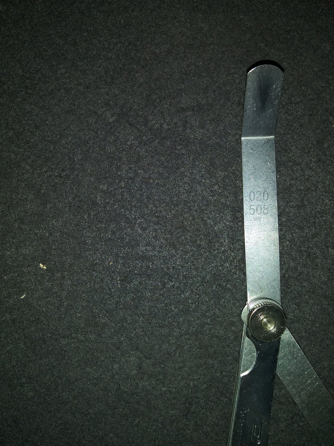

Re: Multiple Cylinder misfire
So i did adjusted the valves Friday and i haven't seen anymore codes for misfire on any of the cylinders but since i adjusted them i can hear the ticking under the valve cover.i just re adjusted them again and I'm still hearing the noise coming from under the valve cover that wasn't there before i adjusted them. The size of the feeler gauge that im using is
.020 intake
.025 exhaust so i dont know why I'm hearing the noise..i didn't adjust them to tight or loose ,but when i first adjusted them they were tight enough to where the the feeler gauge couldn't go underneath them.so what I'm not doing or doing wrong? Please help. A shop will take 200,300 just to adjust them.the deeler would take way more.

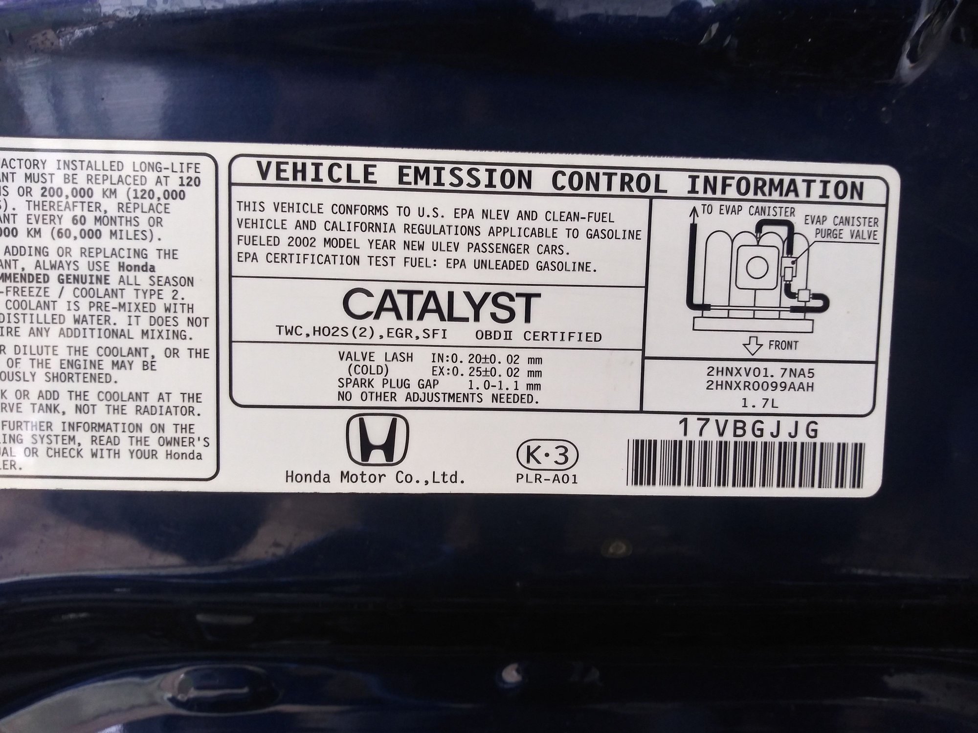

Old Jan 27, 2020
Tracecross30's Avatar
Joined: May 2019
Posts: 520
Tracecross30 is an unknown quantity at this point
So,to everyone that was giving me advice on what to do for my misfiring. I was overlooking one thing that seem to solve my problem,but not sure yet ,but so far so good. I was told to adjusted my valve and i didn't remember that i was told to do that and i did adjusted them and i haven't have anymore codes for misfiring since then but I'm still watching it. I the specs in the service manual said its 0.20 for INTAKE and EXHAUST 0.25, but those spec was way to much i was hearing the valve making so much noise so I called the dealership and they gave me a different sets of specs which made a big difference. INTAKE: 0.007-0.009. EXHAUST 0.009-0.011. I used these new once and it work well except I'm having vibrations but my idle air control valve is bad and i know that could causing the vibration to so ordered one from summit racing so i will see if the vibration will stop after installing it.. My feeler gauge didn't have 0.007 so i used 0.008 for the intake valve and i think i used 0.009 for the exhaust..
The service manual states 0.18-0.22 for intake and 0.23-0.27 for exhaust. Those specs are in millimeters though. This equates to 0.007-0.009 intake and 0.009-0.011 exhaust in inches.
I replaced all mounts about 10 months old..i dont think ots the mounts causing the vibration.there was no vibration until after i did the valve adjustment. My idle air control valve is bad and i know that can cause vibration also. I ordered one from summit racing so when i install it i will see..lets say its the valve causing the vibration. What could really be the cause after adjusting them?.
i used these specs ftom the dealership.0.007 - 0.009 ntake and 0.009-011 Exhaust. But i didn't have 0.007 on my feeler gauge for intake so i used 0.008 and 0.009 on the exhaust..
