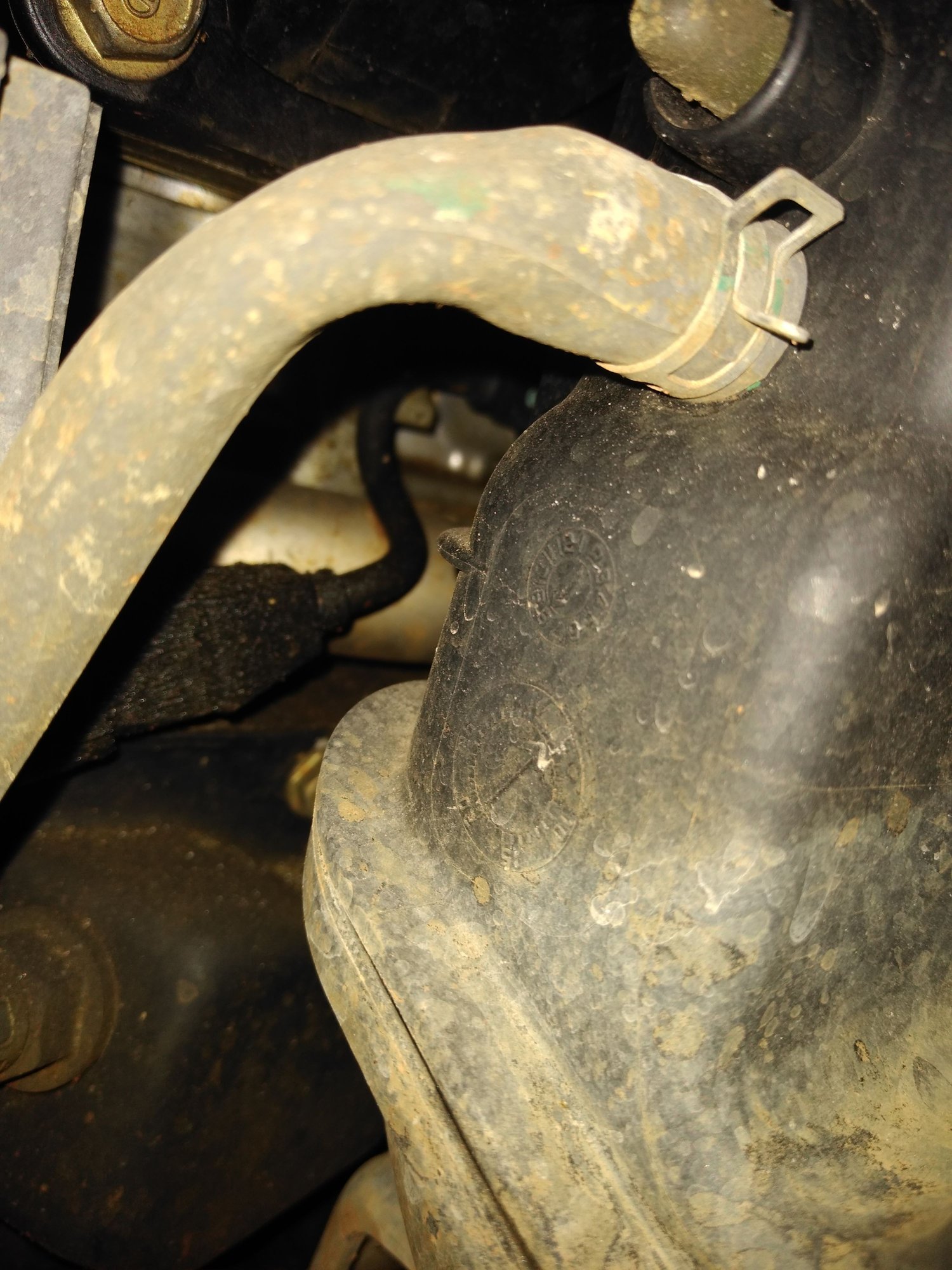

Originally Posted by Butturfly22
i don't if u can see it very well. I took them the other day out of instinct. I didn't even know what it was I just knew it was important. I'll take better ones later. I haven't had car long and I can tell the previous owner ran it into a mud hole or something cause red dirt is all under hood. Also the passenger side floorboard is soaked with water I found out. Can't find that hose they talk about though.. guess I'll have to have it towed. Just gate paying someone to do do something I can do and risk them causing other issues to make more money.
It's a PCV valve. You can replace it when you change the oil.
